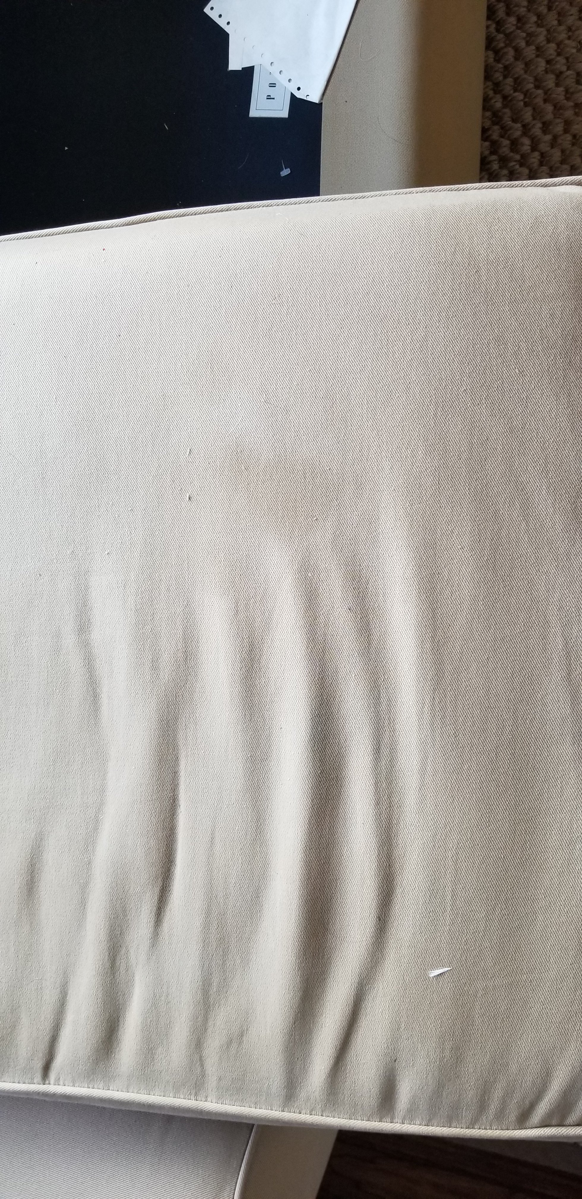

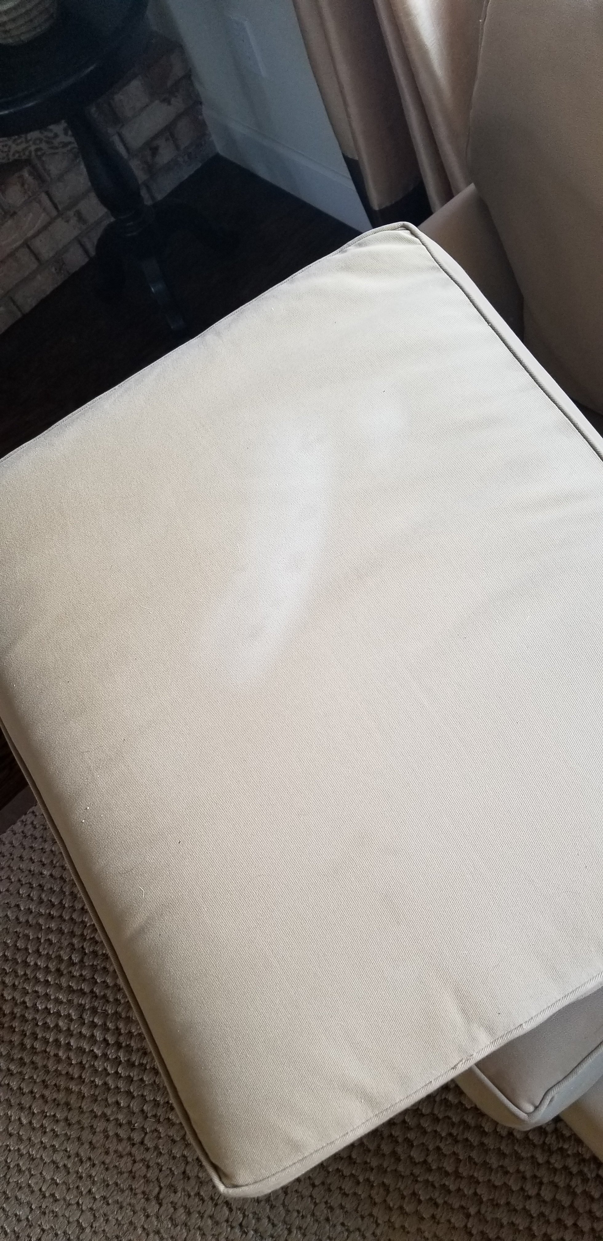

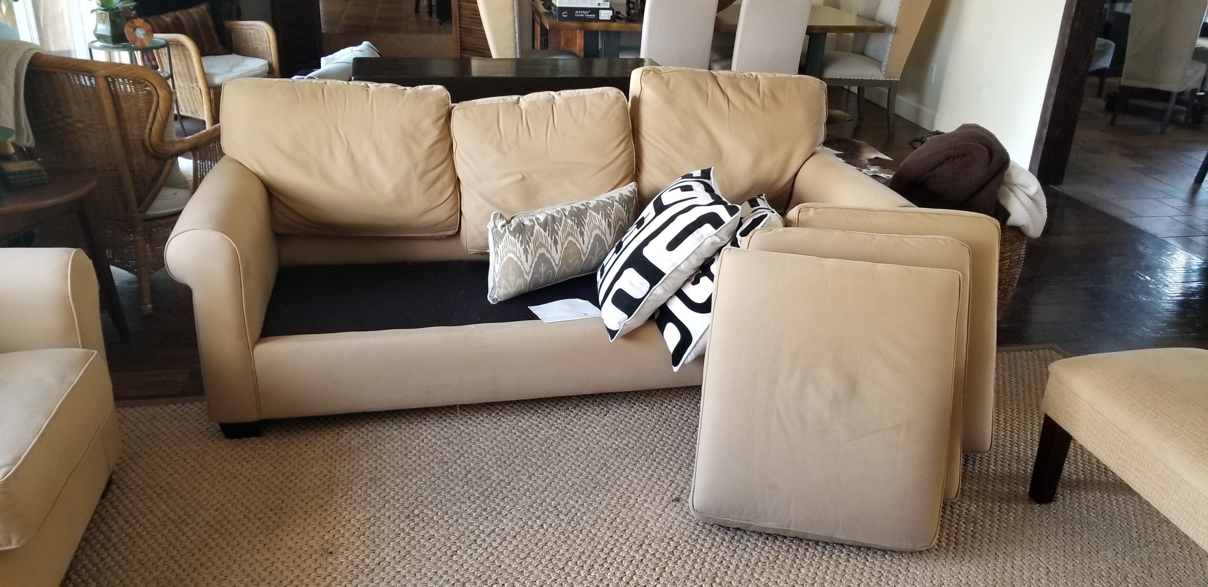

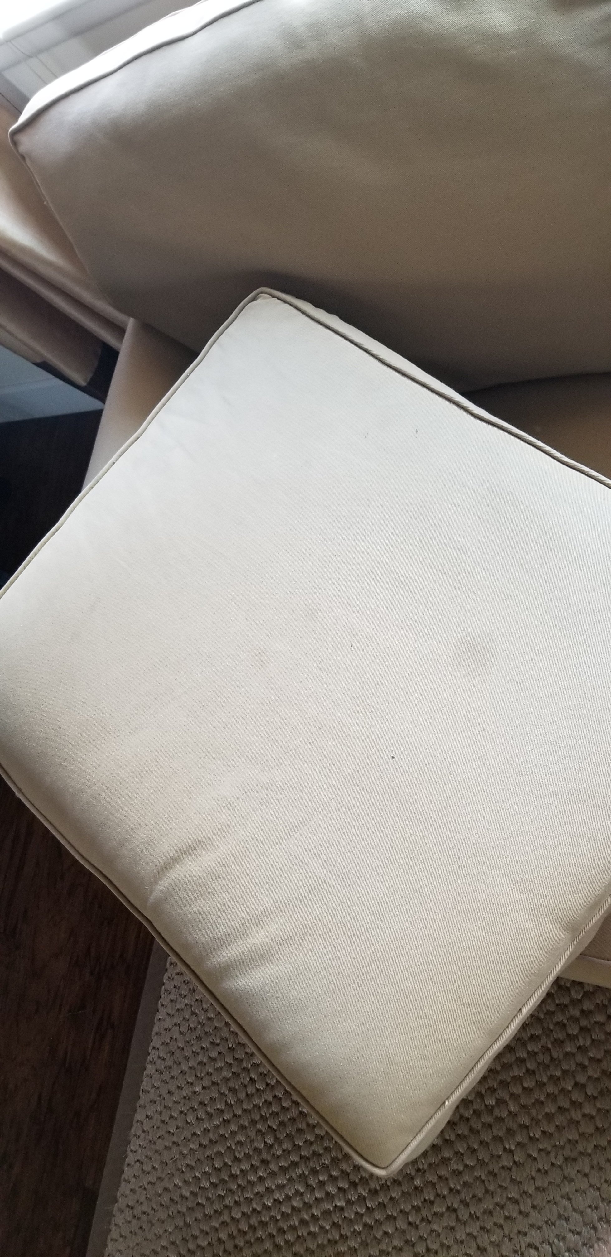

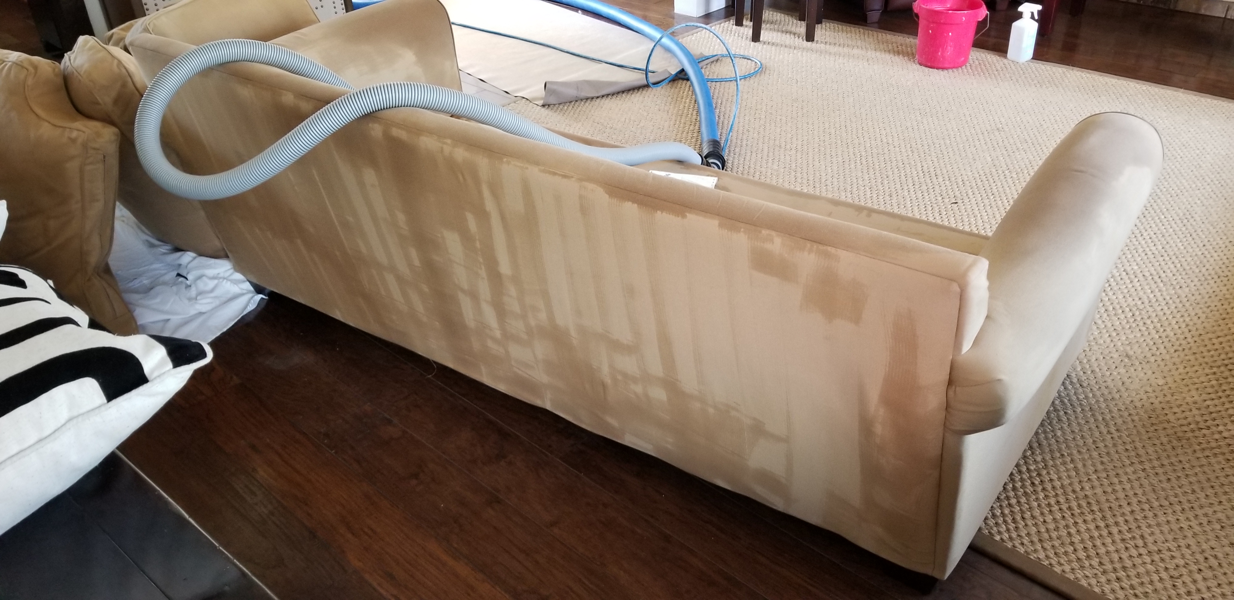

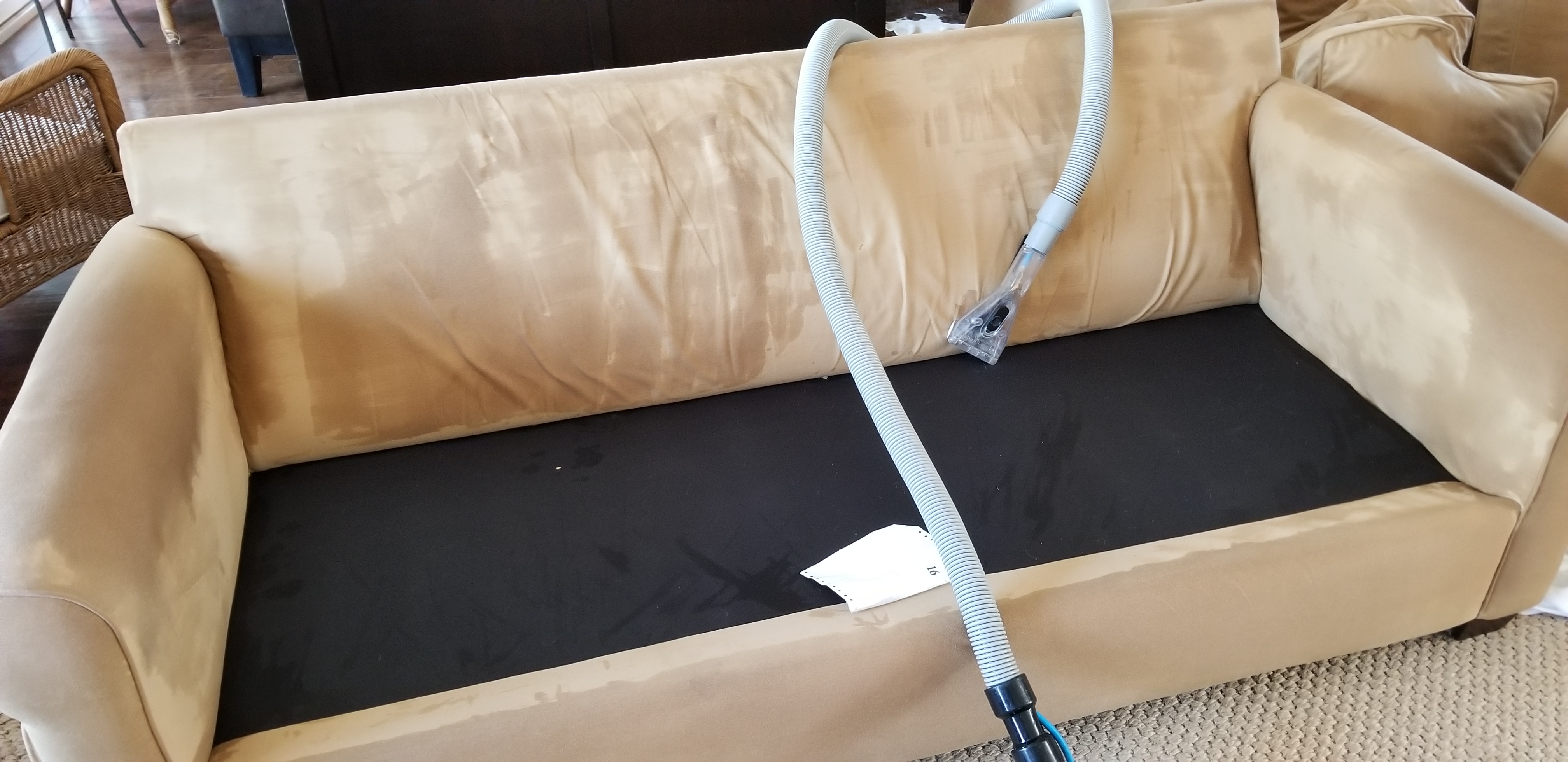

Shes in my lical B2B group.
Pottery Barn cotton of all things..

That one's bad, but some PB are even worse with full skirting and fabric all over about twice a baggy as that. They market it as you can take it off and wash it but people seldom do after they've tried to do it once before...it's a project. Cleaning these sucks.

When they call the fabric 100% Turkish cotton I immediately think... So is it cotton or something else?
Or does Turkish cotton mean the cotton is going to brown/yellow like the old Tahitian/Haitian cottons. Is there viscose blended in there.
I see a lot of the Sunbrella for indoor furniture also from Pottery Barn.
Upholstery cleaning can get exciting very quickly...and not in a good way.

When I do upholstery, especially the slip covers, I use a hose cuff with 4 - 5/16th holes drilled in it so it does not over-suck - controlled air leak.
Try it.
The whitening was already there.

honestly I could just do away with upholstery cleaning altogether... its a great add on but there is nothing I hate more than a huge sectional with loose baggy fabric like that and 30 cushions.
its also the one thing the techs complain about, you can put them on a 12 room home with tile but if there is a couple sectionals in their day your going to hear about it lol
