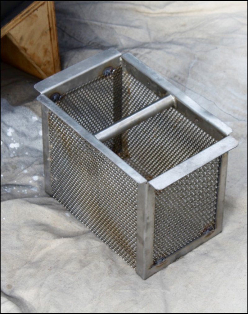

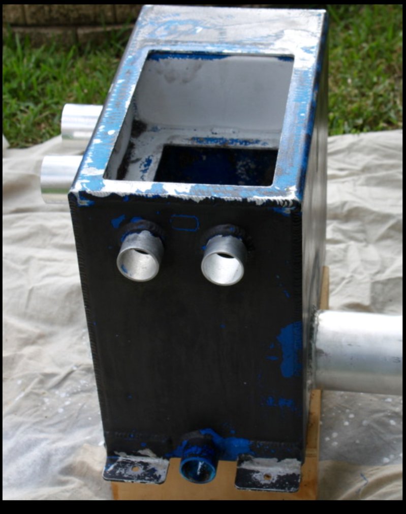

I love the filter box that came with my 5m. Still rocking it. We use tongs to scrap the sides and clean it out.
i modified it a little. I cut the solid side out of the basket and added expanded metal. I still don't see why they make them that way. I also added a 4" port and 2 2 1/2" to th box. When this one dies I think I'd like to get one from hotheatexchanger.com. They make one out of poly.
Gene

Aero Tech wont use a square box anymore. They have figured out that the square box disrupts the airflow much more than a round tube.
