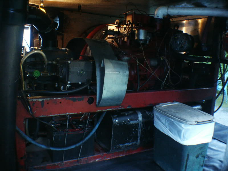

You mean something like this:
only prettier.
has diesel tank on the bottom, about 15 gal
