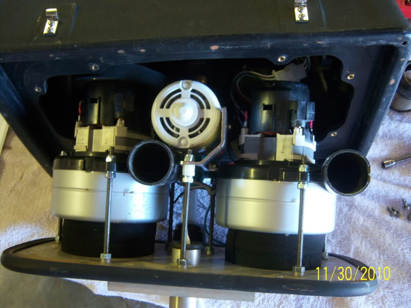

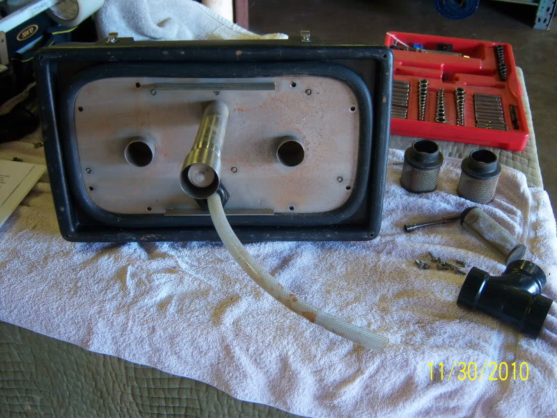

So I got a deal on the rotovac CFX and other stuff. I was testing out the CFX to make sure everything was in working order. Only to find out the previous owner lost a screw to the pump-out and it was spraying water inside the vacuum compartment. I thought I'd take some pics on the guts. I like to see this kind of stuff on equipment. This is a 2 2stage vacuum CFX. The 2 3stage vacuum CFX will have 2 cords to power the unit. I think I may just throw on 2 3stage motors.... I'll see..
Nice feature with the wire-harness disconnect.
A tight fit to get in and out. You need to take the left side out first, then the right. Put in back in the reverse order.
The 4 screws to hold the cover of the pumpout impeller. 1 of them fell in while the previous owner either put on or taking off the cover to check/change the impeller.
