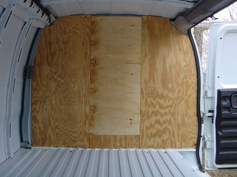

2004Chevvan002.jpg This is what I've done on a couple of my vans. I love it. You can see it goes straight across so I did loose some room for the seat to slide back but I'm only 5'7" so that's okay for me. If I have tall passengers its a little tight for them. You could angle it back like the metal ones for more cab room. It is secured to each side and I bolted a length of angle iron to floor to secure the bottom. The center section can be removed from the cab side.

2 questions. Do you have a photo from the cab side? and how did you fasten to the wall and roof?

The sides are secured with metal screws to the ribs in that location and the top is not attached. This pic shows a piece of plywood I put across the top for rigidity. TM004.jpg I don't have a pic of the cab side at this time. I'll work on it.
