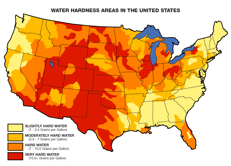

Marty is right!! Alabama has some of the softest water in the United States, but a lot of other cleaners need to take notice. https://www.google.com/search?q=wat...AhUSyWMKHZvtCl8Q9QEIKTAA#imgrc=hmXacXBVZ1BKEM: We have previously attributed this photo to the Salt Institute. The google search shows more hard water related maps.

Water hardness from city is about 7 grains... Not too bad.

The higher the heat of the truckmount gets you closer to vapor, the more the minerals want to separate from the water attaching to metals in your truckmount system. So 7 grains with high heat could act more like 10 grains. Water is soluble, vapor is not soluble. We get reports that high heat truckmounts are impacted more by minerals forming hard water than typical truckmounts. Of course an operator can choose when he needs high heat and turn it down when he does not need high heat.

Tom is so correct.
We noticed more scale build up problems when we got higher heat units.
I will Descale more often and we also run water Softener in shop and have in vans (one currently and not installed in other yet... If ever) but you need access to softened water and keep testing your soft water source in my opinion and experience

Seattle is very soft water, less than 70ppm

My van came out of new Jersey and for a couple months the filter was full of crap. I descaled it a couple times and replaced all of the leaking controls.
That map shows jersey having good water

I had Kenetico's on both trucks from 2007 to 2009, noticed no difference. Central PA has excellent water, in 42 years never descaled a truck mount.
