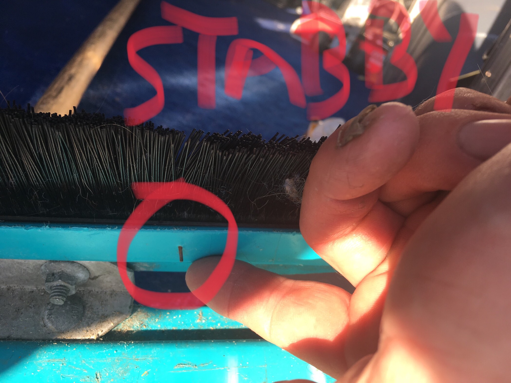

I never have issues with the staples not holding. My issue is that the staples keep stabbing me when I go to grab it. Rivets would be a better option.

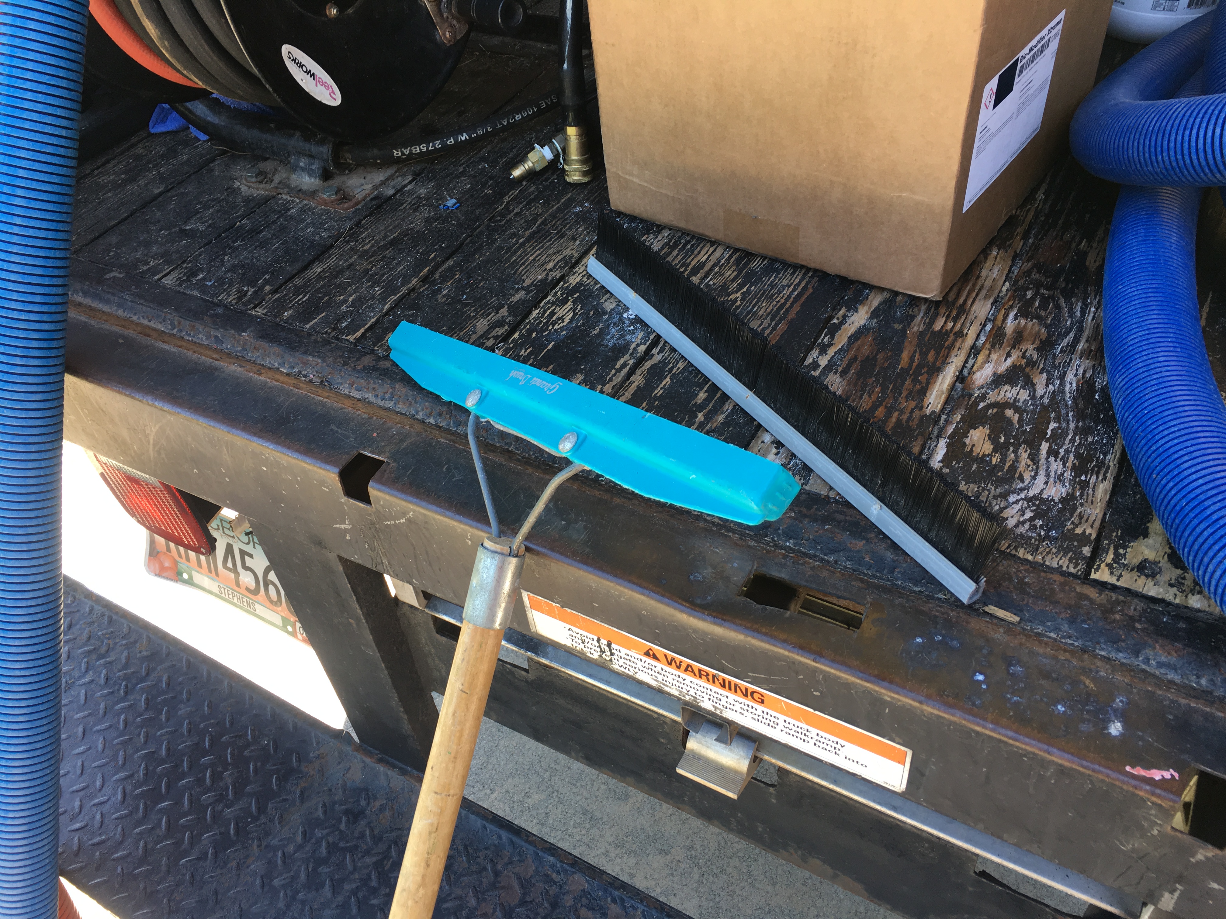

I was out in the hot sun today, pulling a mikey, grumpy and grooming a wool rug I just cleaned in the driveway, because the customers were too stubborn on letting me take it to a rug shop, and the head fell off like you see in the pic when I was finishing it.
I'm cooled off now, so I'm in a better mood.
Staples, brads, there's not much of a difference. Why not just screw it in? Seems like a more reliable way. That's what I just did today

Or, when it pops out, go into your garage, grab a cordless drill, 3 #8- 1/4” screws, and fix it... simple, never have a issue again...
and throw some glue in there
I put clear silicone in mine, drove in 3 stainless screws....
