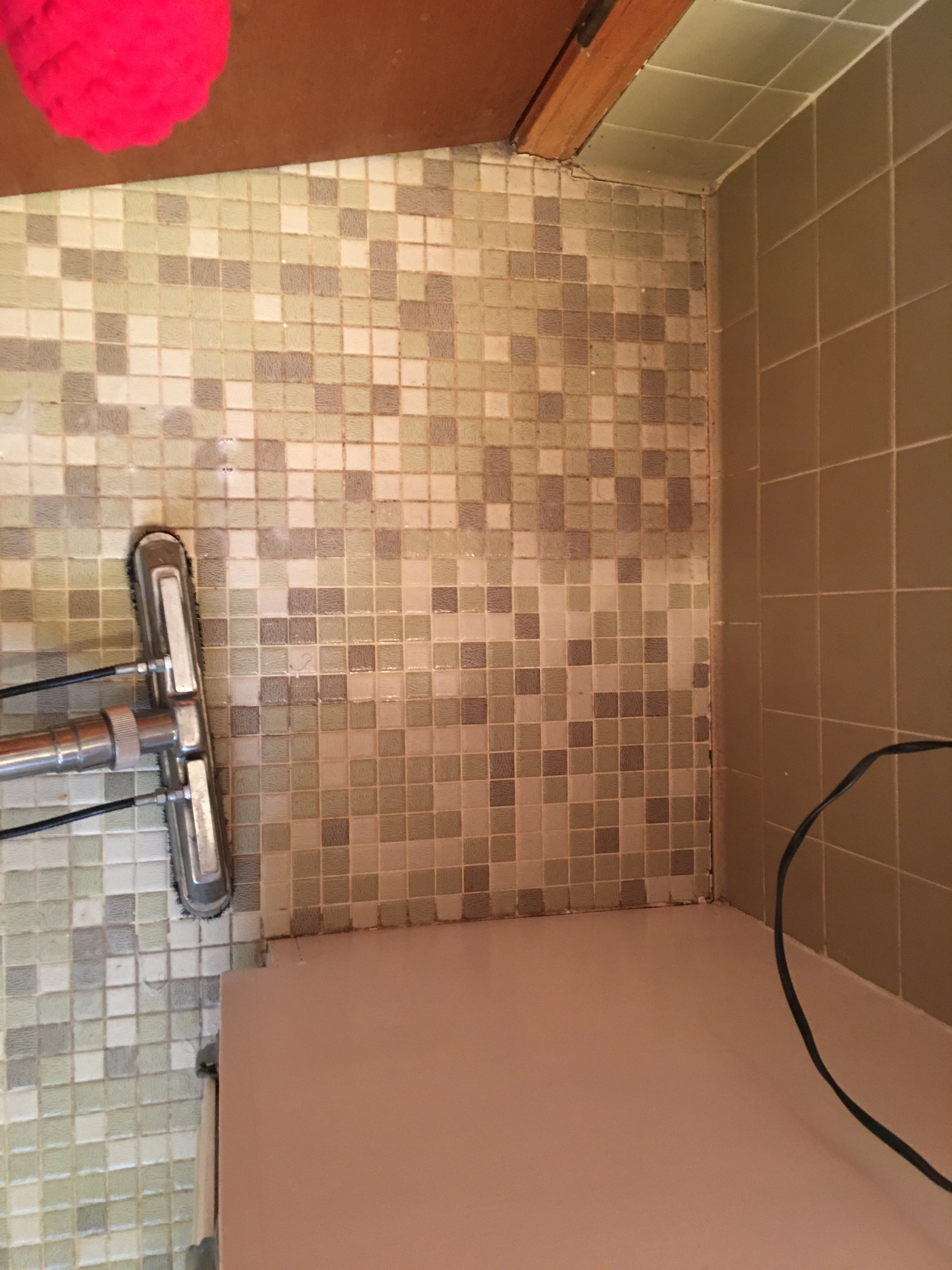

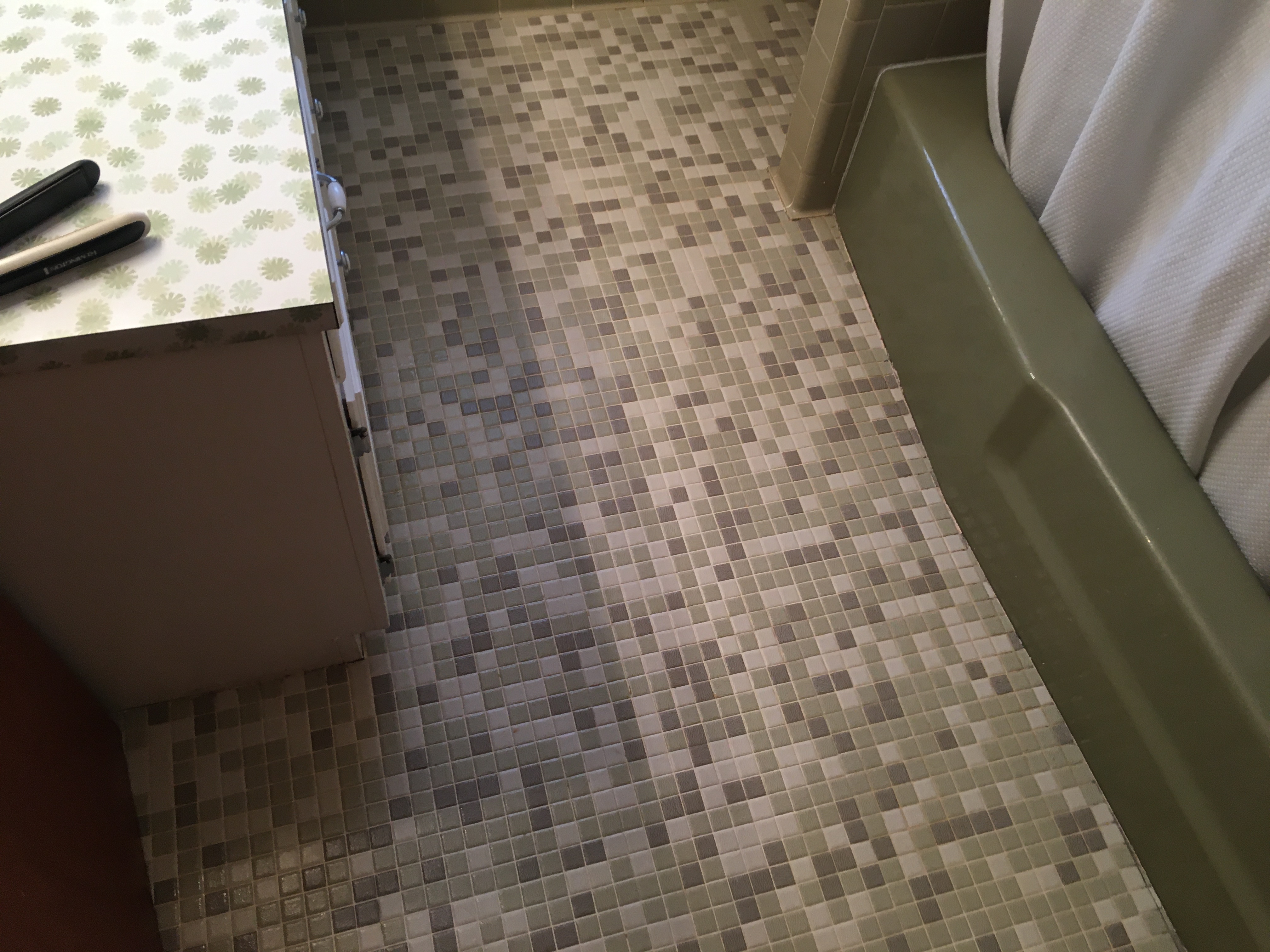

I used just that acid rinse to treat this tile yesterday
That grout looked brand new after. No agitating or any alkaline Prespray.
