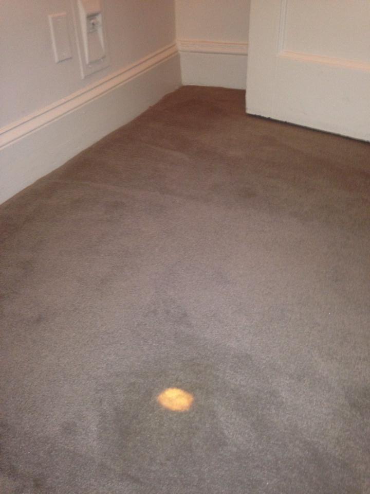

Sure do. We use it frequently to remove hair dye from carpet.
Here's an example of an old hair dye stain at the Lombardy Hotel in NW Washington, DC.
1. Bleach out hair dye
2. Neutralize bleach
3. Re-dye carpet

They don't have any more of this carpet left over. I charged them $450.00 for this repair. They were fine with that. I've been taking care of this luxury hotel along with all of their other properties for the past 16 years. They don't even ask my pricing. They know I'm going to treat them fairly and save them from having to replace their carpet.
