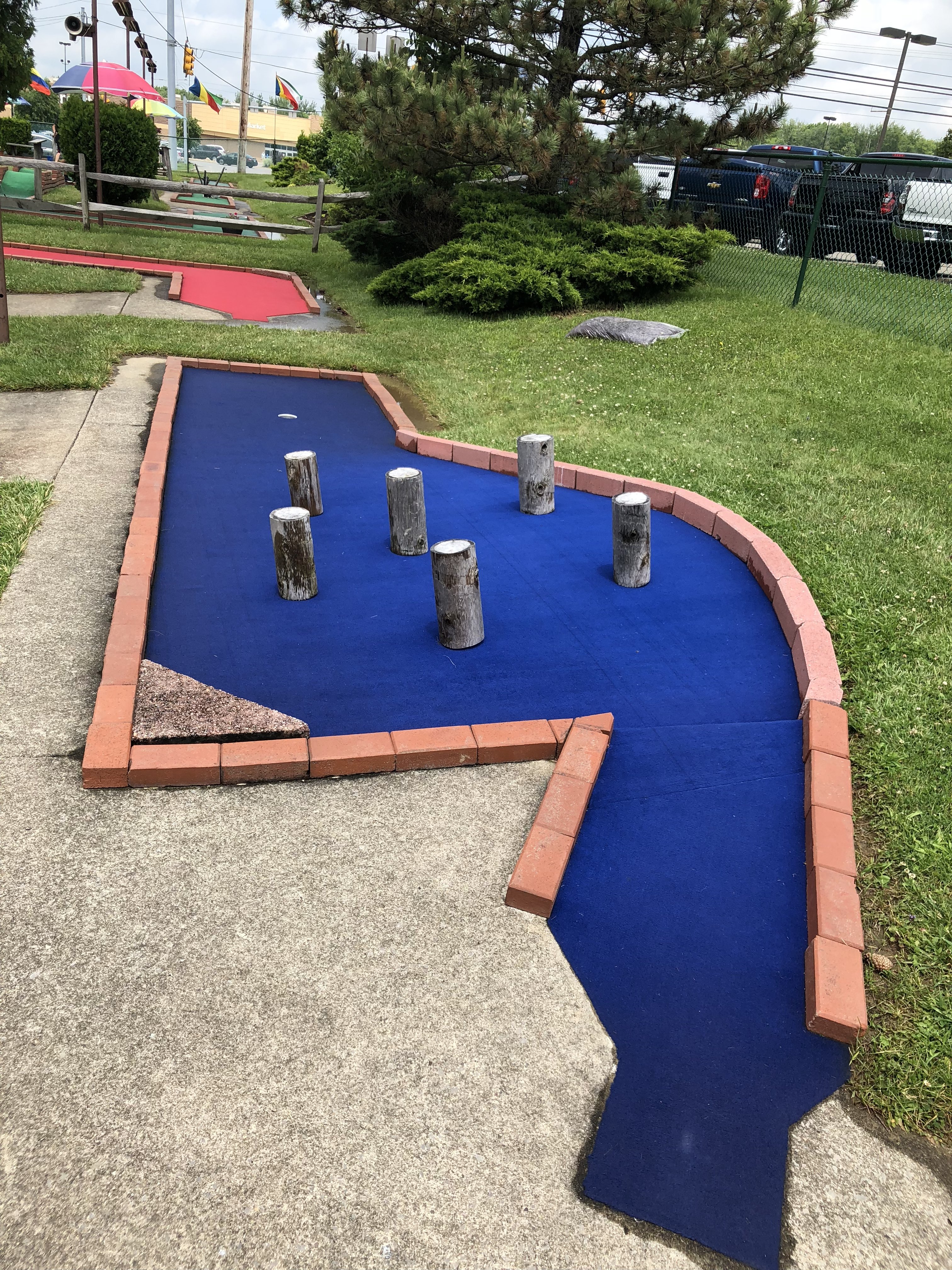

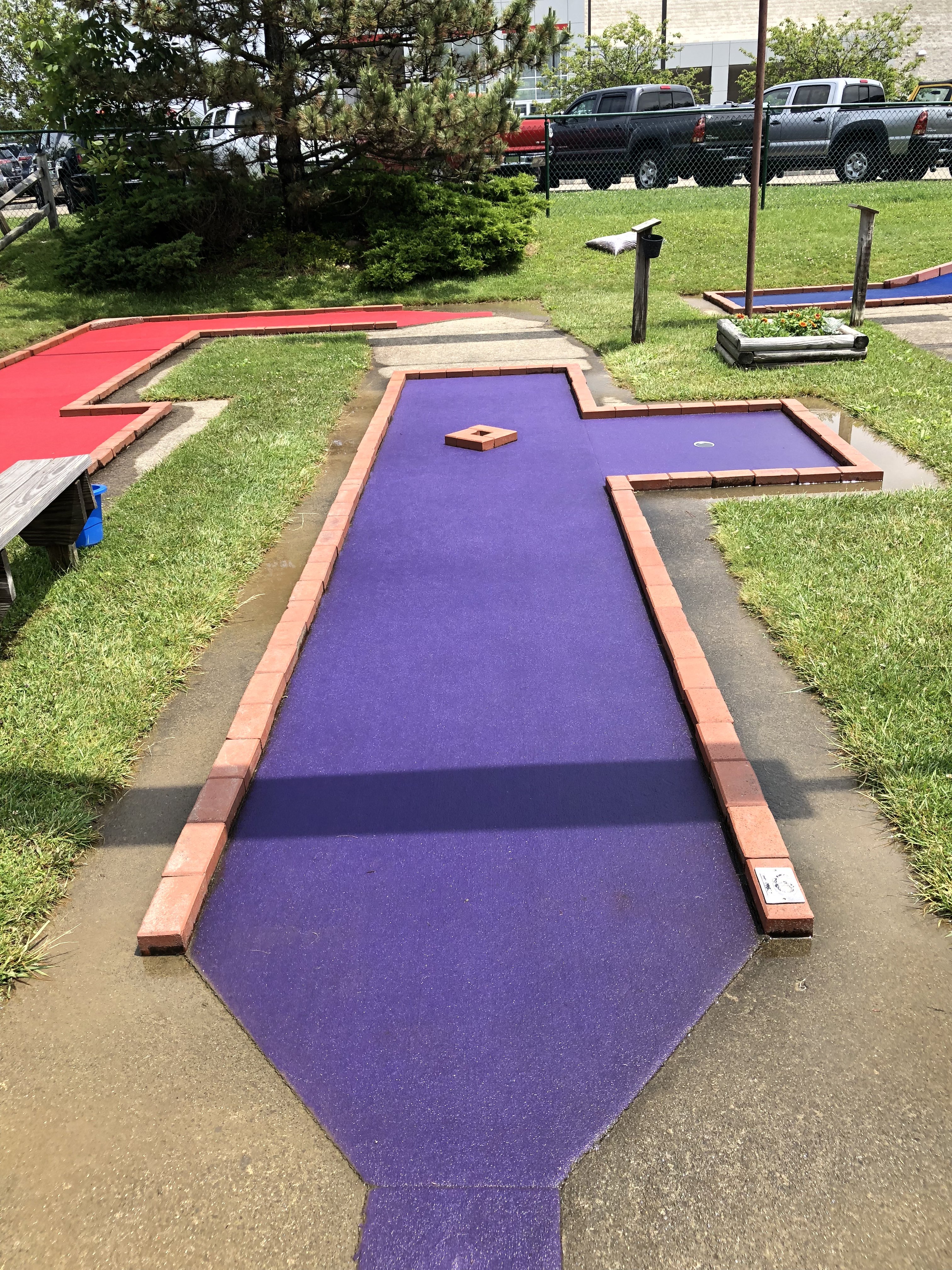

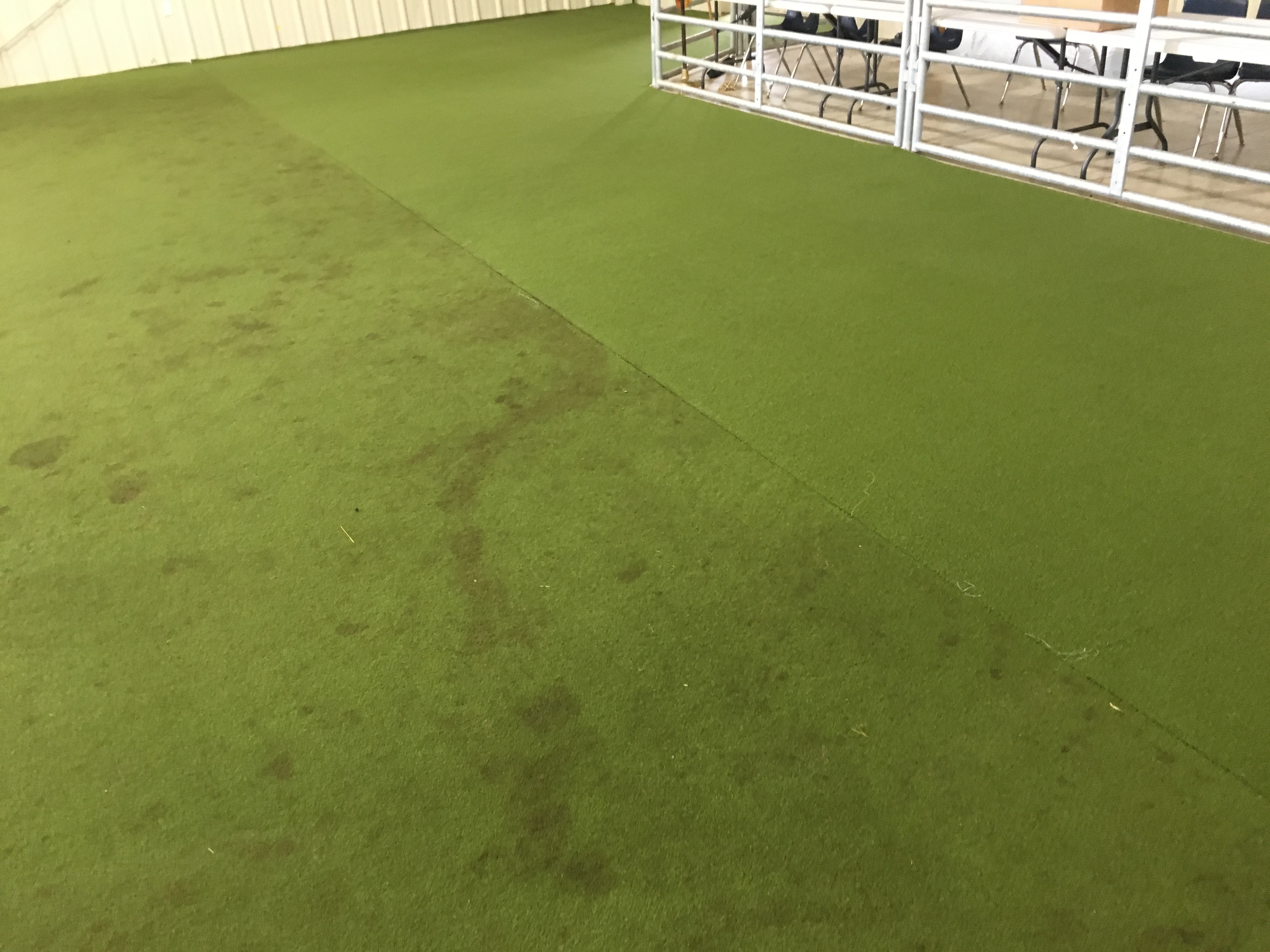

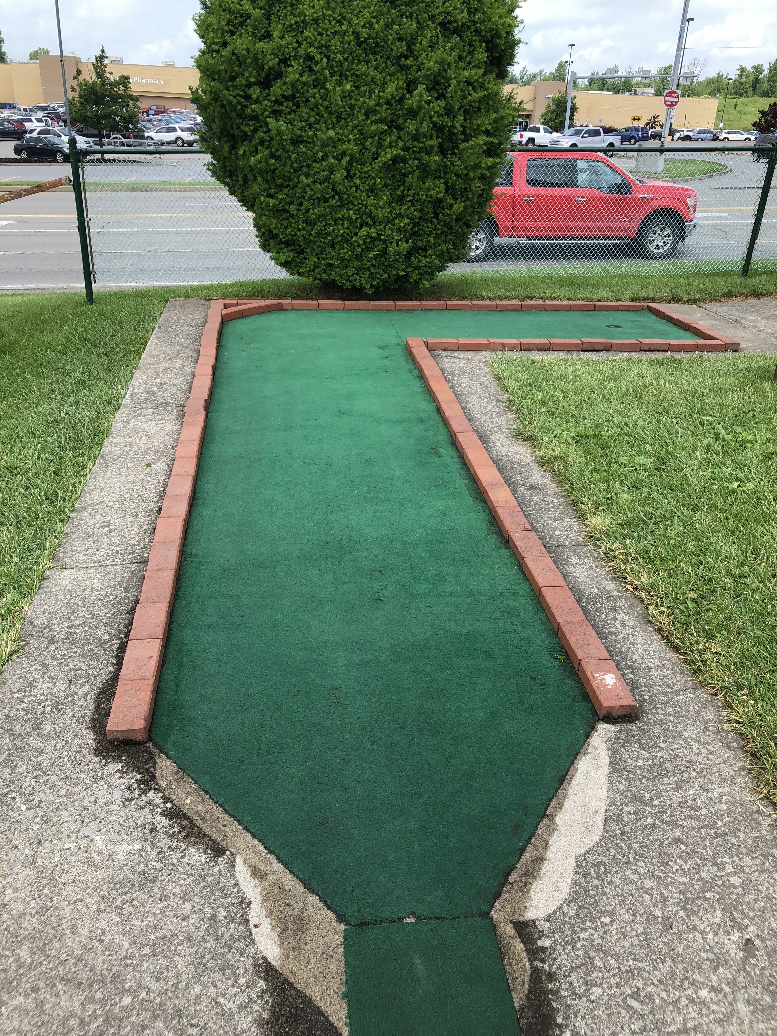

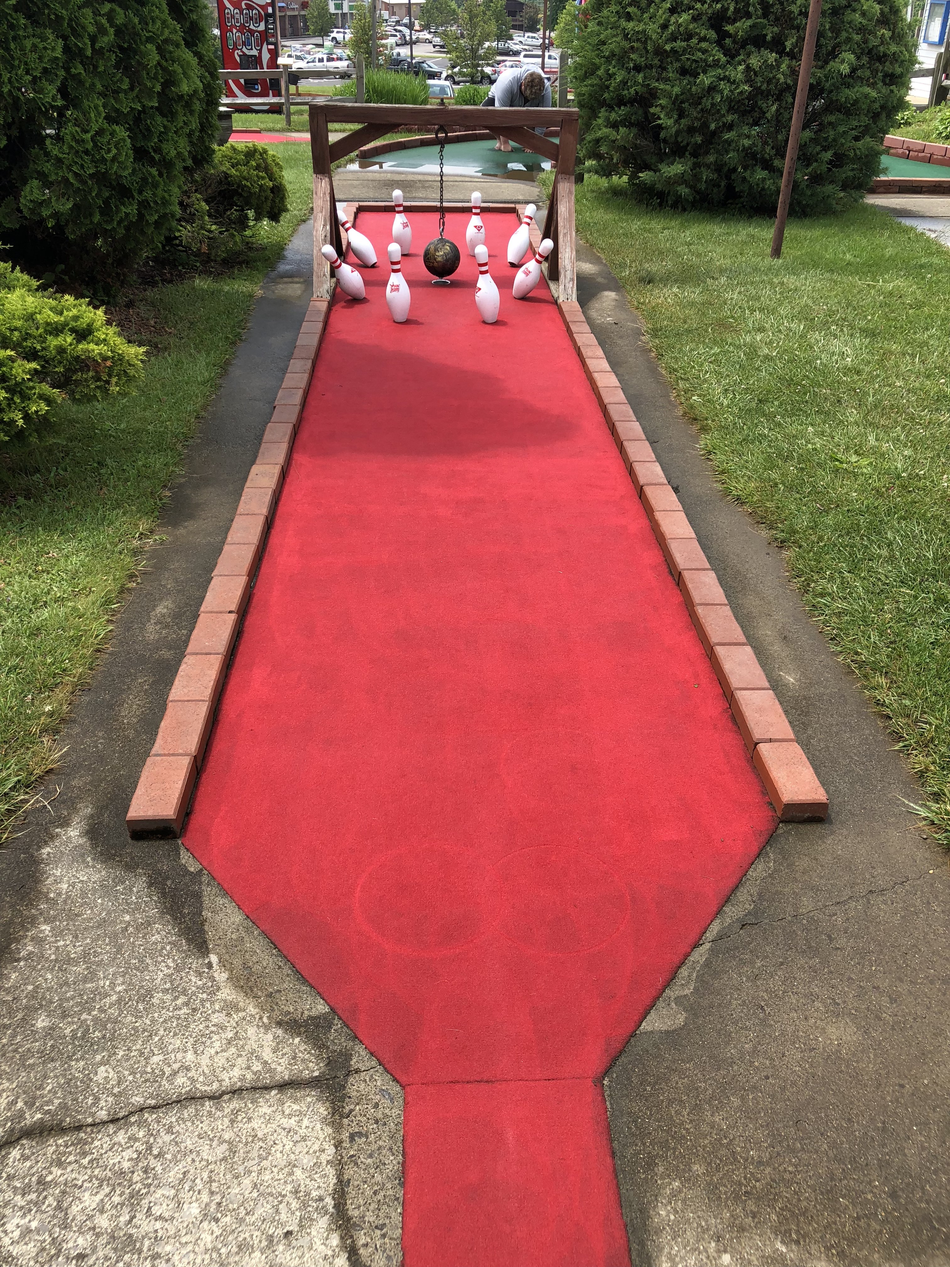

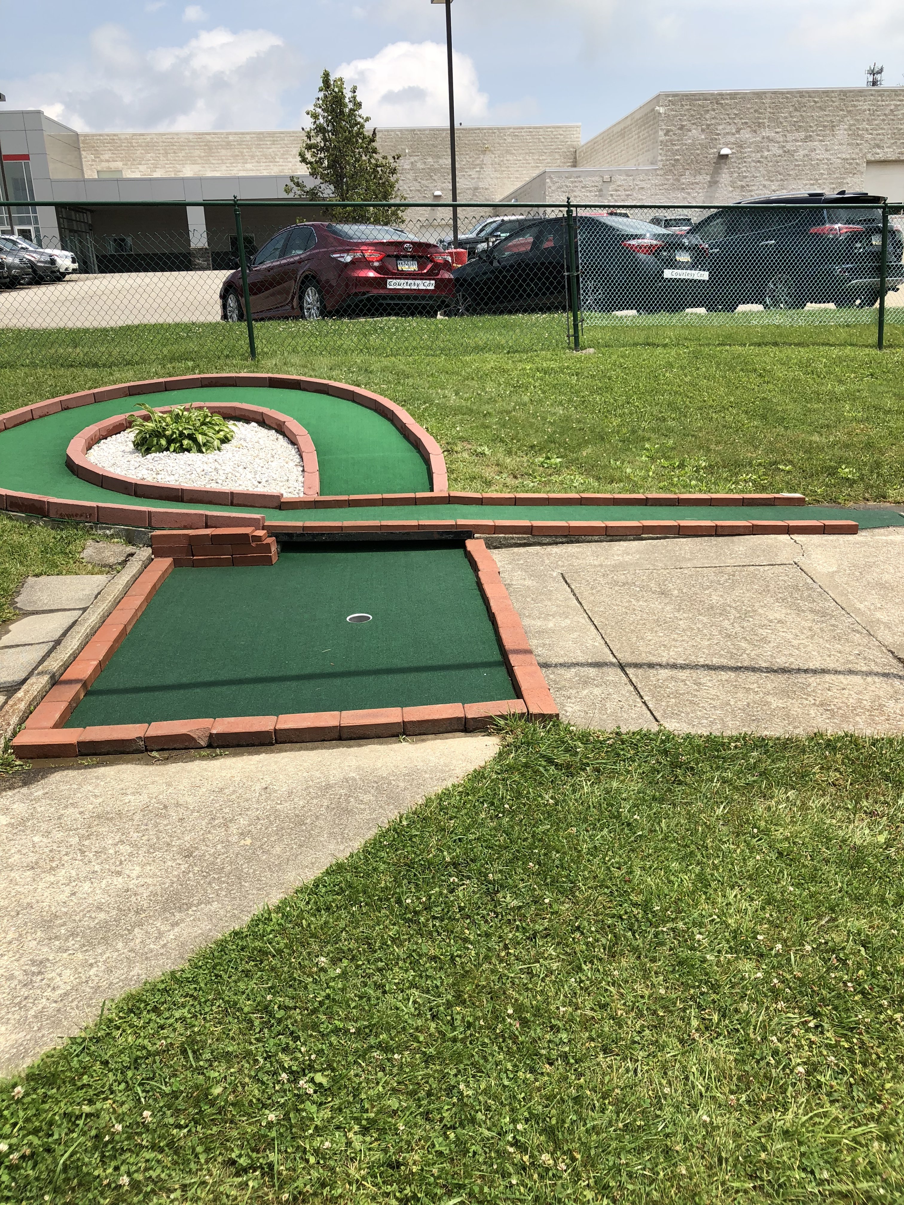

Anyone ever clean carpet at a mini golf? It looks fun :) Best practices you can share?
234D2442-8FF6-472A-BA7C-05E4FBF724F0.jpeg 38E75E5B-67F2-4882-A0E0-FF60F379D332.jpeg 35841EAE-B2CB-4DD0-8DB5-BA6FE5C24959.jpeg 0BC8CFE9-EFF7-4E50-9BA5-A34AA0F62DA4.jpeg E280CA5D-EC50-419E-B513-1730B73BB8DD.jpeg

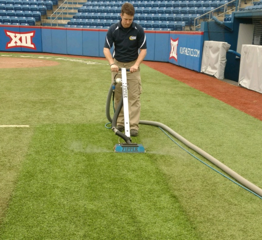

Encap it. According to the guy that gave the encap talk at Fl Mikey's fest. He encaps for $.70 per sqft and does football fields. Gets results nobody else could get.

The guy says his 84-yr-old mother pressure washes the greens every year because no one can do it better than her (in her opinion), but he wants to have it cleaned so she can sit this year out

pre-spray, pressure wash 'n squeegee
Just have enough sense not to use too high PSI pressure washer (or jet too close if big PW'er) and use soap that doesn't kill plants
any mold (dark splotches in shaded or low spots) may require a bit of agitation
14,641
If all the bleach isn’t rinsed off, someone could walk on it after a rain and have some mean footprints when they walk on a carpet inside the building.
I’d attack any mold stains with vol40 in the sunlight
