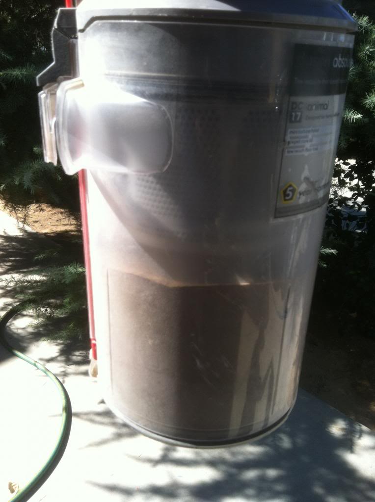

That straight pack out soil at a front door filled my dc17 4x with dirt no RE will dig that out it will just make mud.
It was so packed out the carpet was like a board was soft when I was finished.
