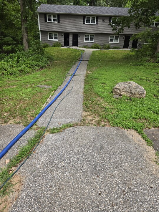

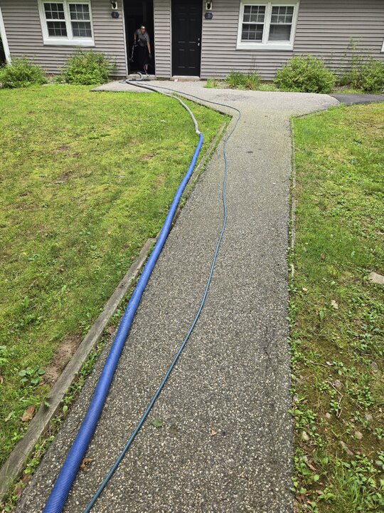

I did that....once.
50,039
You can gadget yourself to death in this industry and suddenly find you’re spending more time setting up and taking down than you do actually earning your money.
KevinD
Nov 23, 2006
2,550
Kevin Dumas
I never used yard sticks but have been known to slide the solution line down a 50 footer of vacuum hose for protection.
Works great here in the Northeast in the winter also.
