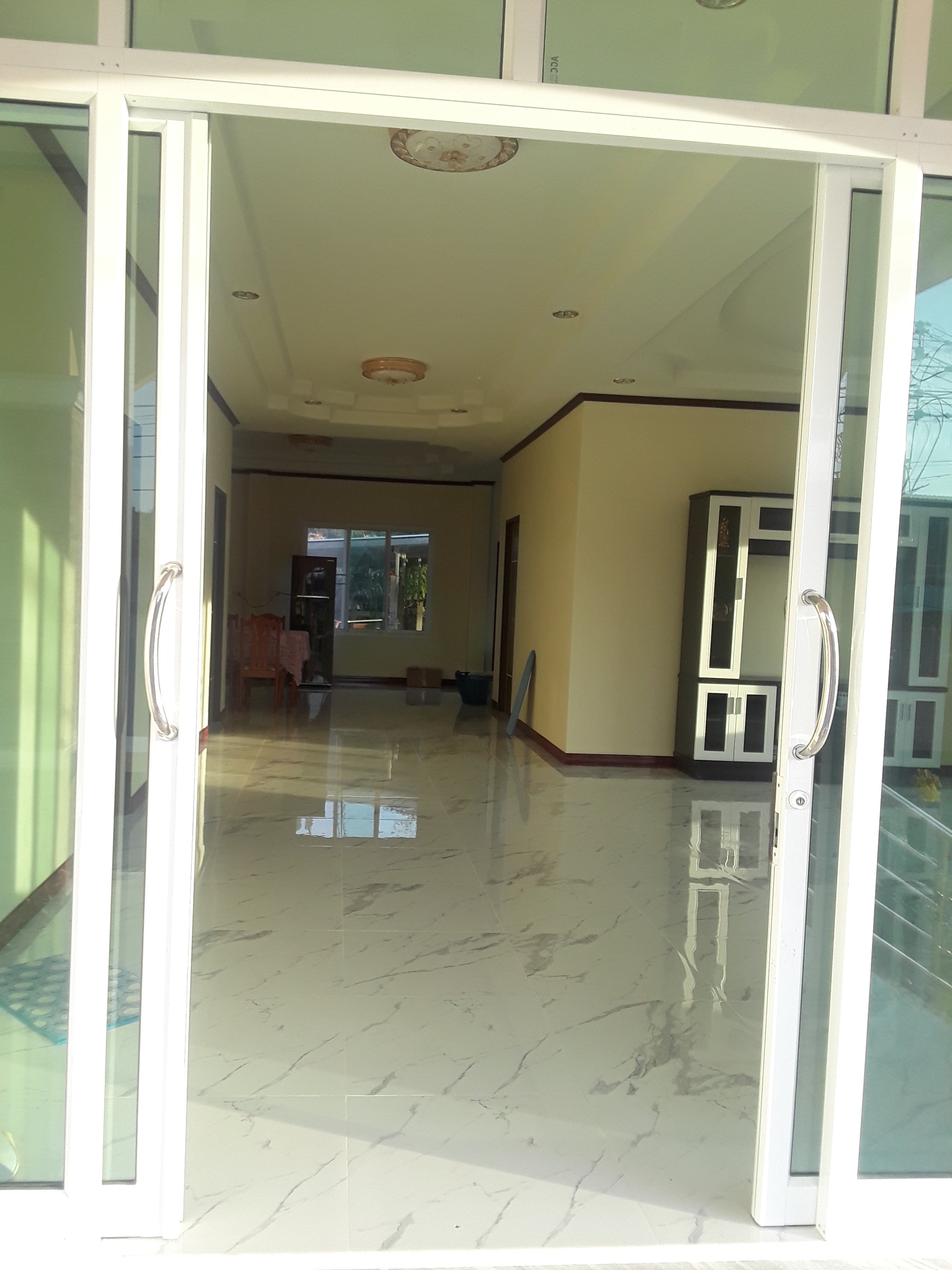

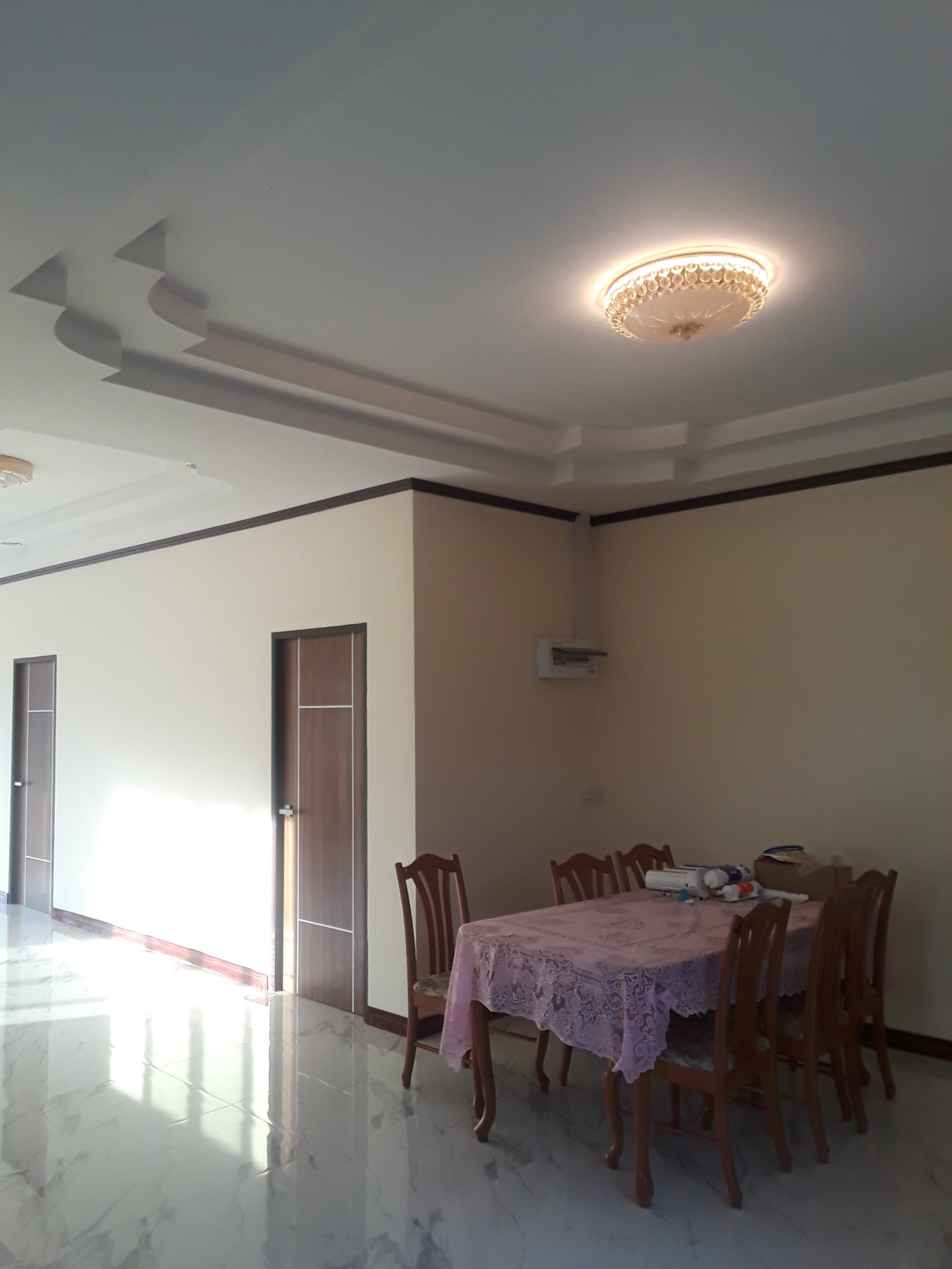

I'm sure I need to seal the grout in the bathrooms and floors and granite counter top; but does the porcelain tile need to be sealed also?

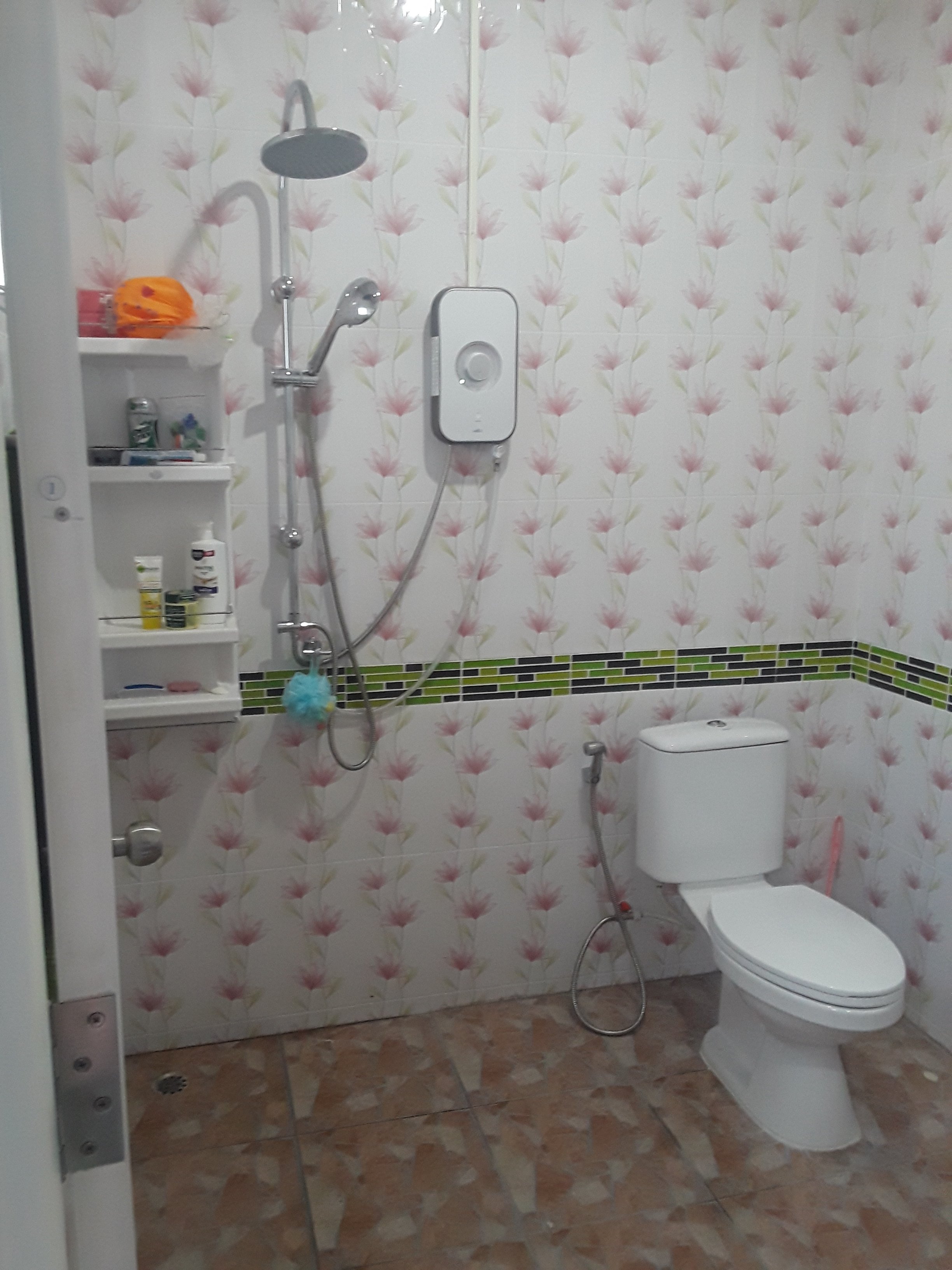

Thats the style in Thailand and I admire its simplicity.
The sprayer next to toilet is a poor man's bidet. We dont use toilet paper, because thats just 3rd world.😉
The rectangular thing next to showerhead is an on-demand water heater- cost less the $100. The whole bathroom basically gets cleaned multiple times a day.
The sink is across from the toilet- out of view in the photo.

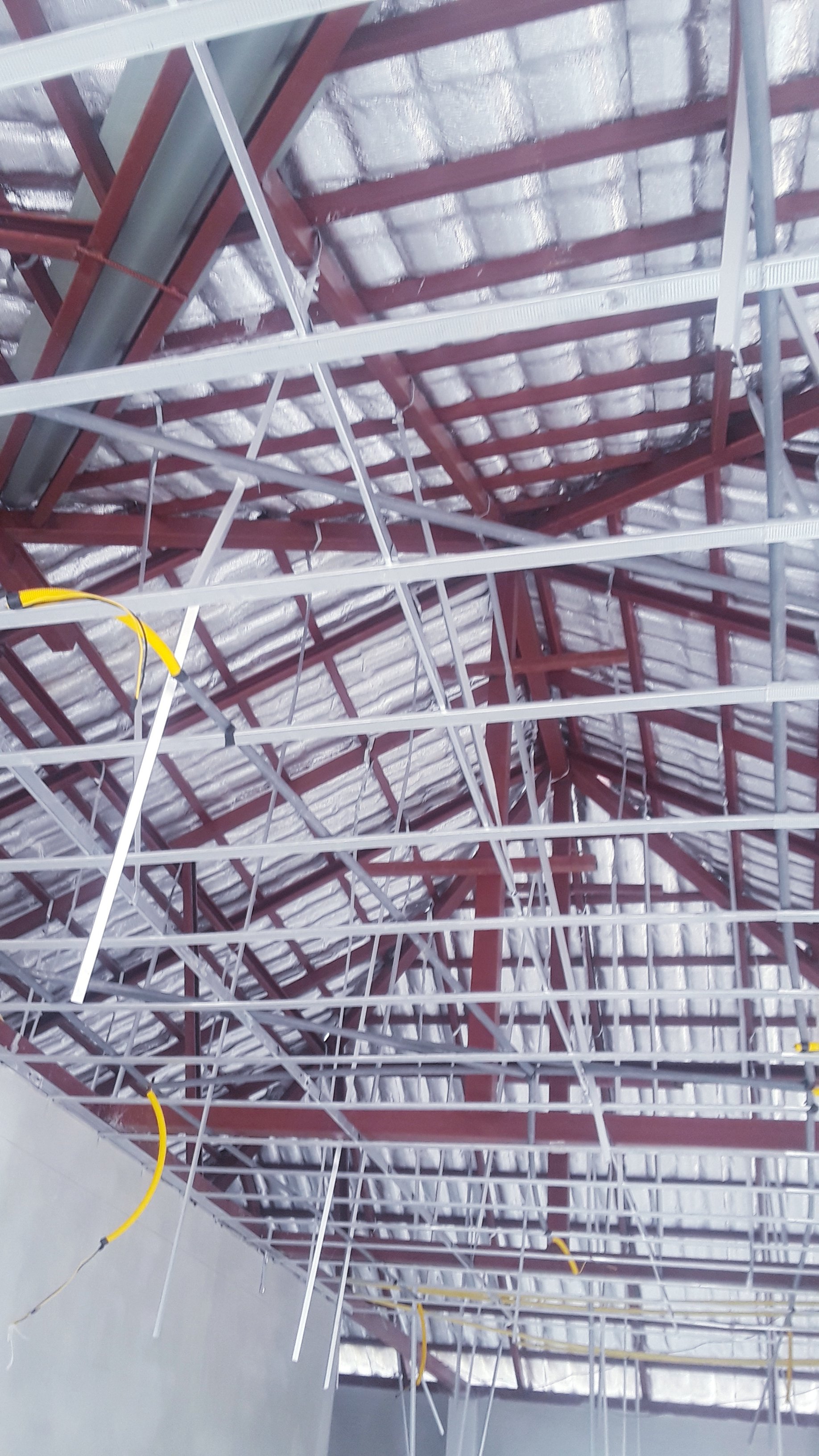

Wood is expensive in Thailand.
The roof is welded steel beams with insulated fiberglass shingles.

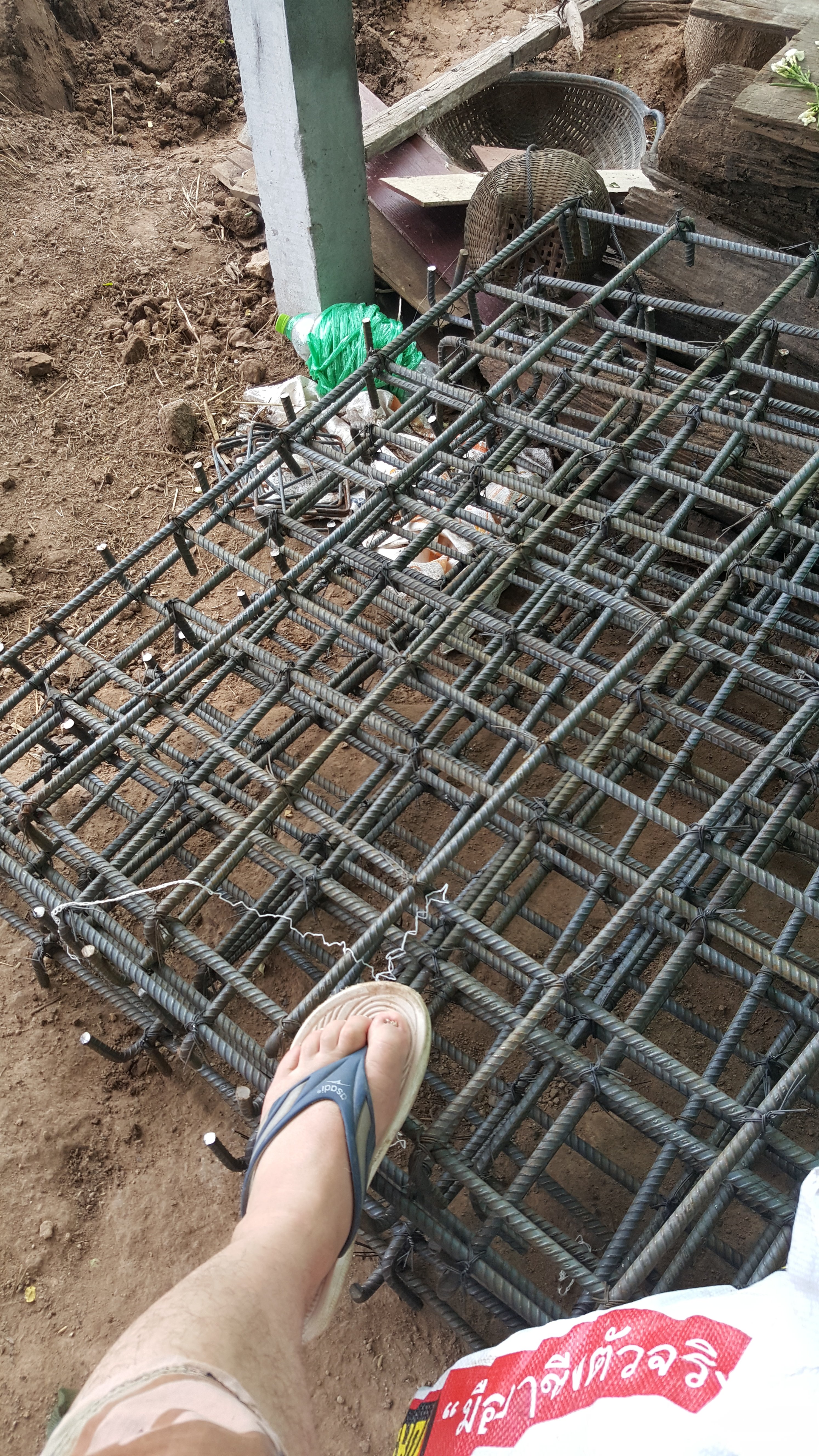

The support pillers and floor are made of cement and steel.

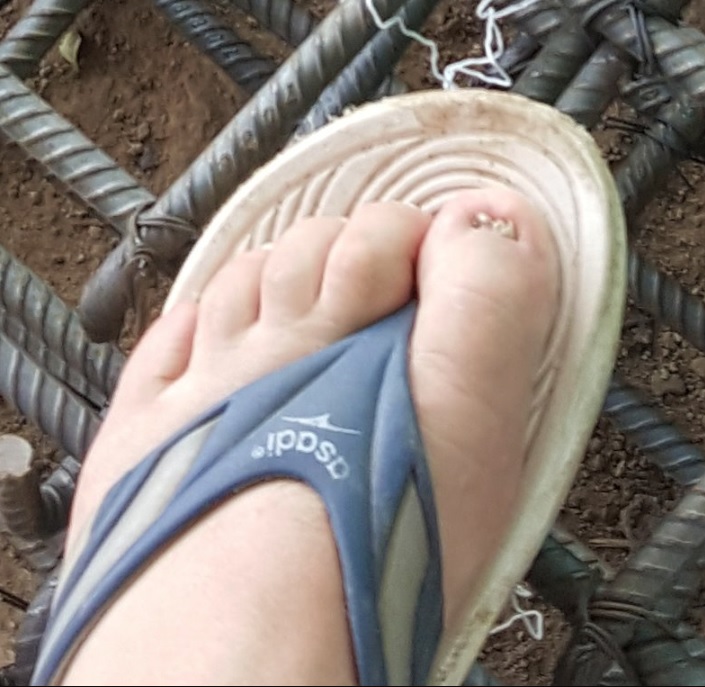

As a former cement slave, I was impressed with their steel tying.20190524_000933.jpg
As a former cement slave, I was impressed with their steel tying.View attachment 95646

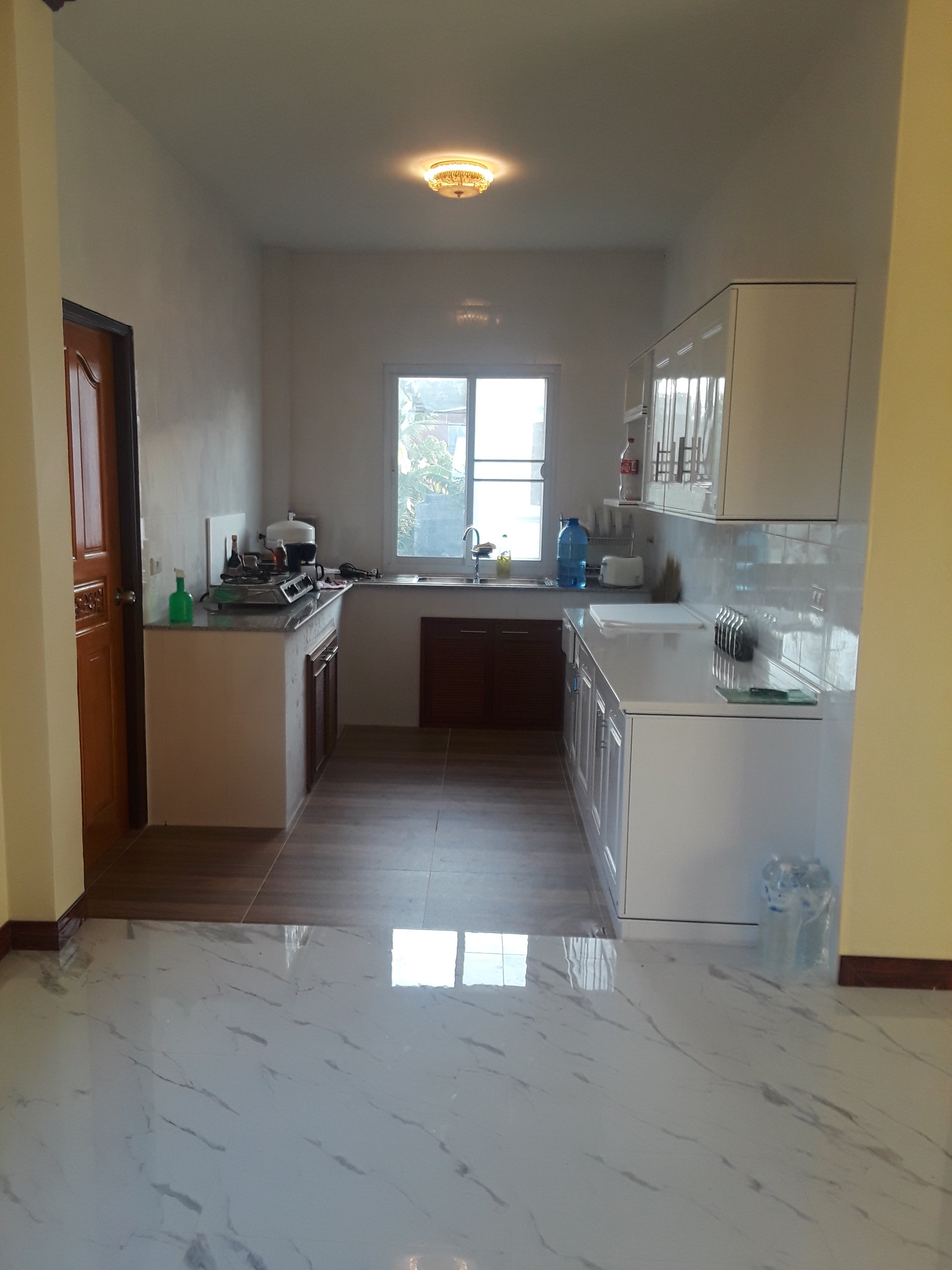

John, Where do you put the fridge? Looking at the picture of the kitchen, I couldn't figure it out. I like the floors.
San Francisco, CA
High gloss Porcelain has a "baked" on (in a kiln) glaze that is like glass. It does not need sealing (a waste of money).

Finally someone answered my question. Lol
Thats what I thought.
Boy was it a challenge to find a sealer. They could grasp the need to seal stone or grout.
I would have preferred a penetrating sealer. But hopefully the stuff I ended up with will work. I'd post a photo of it but the lable is in Thai. I'll test in a small area of bathroom first.
Unless... it's the currently trendy matte finish. Every fingerprint or oily spot will look darker, so sealing is needed. The industry has caught up and now you can find sealers made specifically for "microfractured" tile.
