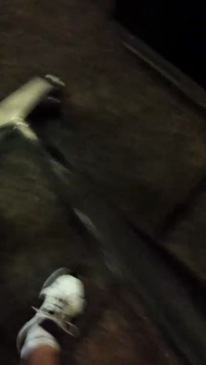

Does the forward stroke clean better?

I clicked it and it worked and yes the forward pass seem to clean better but, was the back stroke pass conducted in a more traffic area than the forward pass.
As it appeared the forward pass was closer to the wall and regular style was conducted maybe in a more trafficked area a bit furthe out from the wall?

When we were testing the "forward vs. pull stroke" , the carpet was sprayed with the wand held up in the air.
That way it was evenly sprayed before any extraction strokes.
Sorry if that wasn't clear .
Larry

"If" it really is cleaner, I think it may have more to do with the additional dwell time the solution has on the carpet.

Ron, on your first test you sprayed solution only, then recovered it during the one and only pull stroke. On the second test you keyed while pulling - recovering as you went, then did another push and another pull, for a total of three strokes (both pushing AND pulling) after the solution was sprayed.
Of course the second test turned out better.....
It seems pretty simple to me - forward stroke tends to force the wand into the fibers, increasing recovery, while pulling the wand tends to lift it off the fibers, hurting recovery. But if you do both - as in keying during the pull stroke then pushing back to where you started it's a moot point.

:icon_rolleyes: The dry pass wasn't necessary but for some reason I did it. Stop the video after I do the ONE pass and look. Too damn many variables to think of at 11pm.
I don't get your test Larry, you're air wanding??? Did you spray the carpet then just do a forward dry pass on one side and a backward pull on the other side?

Ron;
We sprayed the entire 4' x 8' area with solution from the wand.
Then we extracted with a 10# weight on the wand head, applying only horizontal force to move the wand in both directions.
Larry

I don't think he said it cleans better I think he said it generates 10% more lift on the forward stroke.
Which depends on wanding style to if you lean hard and press with your wand like Bob Vawter at MF 10 you probably get 20 % more lift and a wand that screams get off me you .....

The forward stroke generated more than 15% more lift
AND cleaned better.
I still don't understand the physics involved.
Larry
11,182
Ya but you added a 10 pound weight and cleaned better visually??? I will push carpets to make a the pile look better when its just fugly.
I understand how sheer works, but maybe some of the solution is sinking soil rather then extracting on the push! I think there are a lot of factors to just say this works better.
I would like you to do what Caponi suggests do the forward stroke a backward stroke then use a IR tool to see what dries faster.
I can see a thick piled carpet creating more lift on the forward stroke theres more weight on the wand going forward. your pulling and lifting a little on the back stroke.
I usually run the water forwards and backwards 2x when cleaning most areas then dry stroke my NNNNNNN's into the carpet.
hopefully your not confusing the nap being lighter one way to darker the other for you conclusion of what cleans best.

Larry, I would agree there is more seal, higher lift, on the forward stroke. The recovery depends on how much lock down there is, which is why the glides improve the recovery, they don't lock down but allow the air to flow.
There's a difference in the recovery from what would be the rear vac slot to the forward. Recovery from the rear slot would be no better than what I showed in the back stroke of the wand, basically flooded carpet and the vac recovering the water. However, when doing the back stroke with the jet on, the water flow is towards the vac and can flow through.

Forward stroke seems to blow the soils out better in some cases.
Had one yesterday, bad transition approach into a kitchen from the living room.
Rear stroke made a big improvement but dang when I went forward an was still hammered down on the trigger she sure showed her colors.
I'll wand forward, backwards, sideways or upside down if thats what it takes : )
