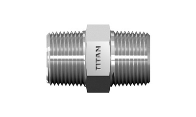

Lookie here, $40.00:
https://www.nosoupforyou.com/wp-content/uploads/2016/03/1934-Soft-Touch-Stainless-275x275.png
13,372
The use of softer materials that connect to harder materials is done for a reason. Two pieces of stainless will kinda weld together making it unable to be removed easily.
I haven't had a brass nipple break in years. When they did I was able to remove them with pliers. If it were stainless the easy out would be the only way.
