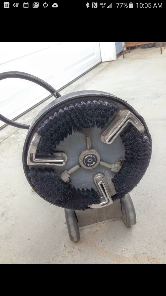

Look closely at the shoes - looks like the hammer has already been applied several times....
Thats why I posted that photo..
He now has to buy a new head due to lack of maintenance.

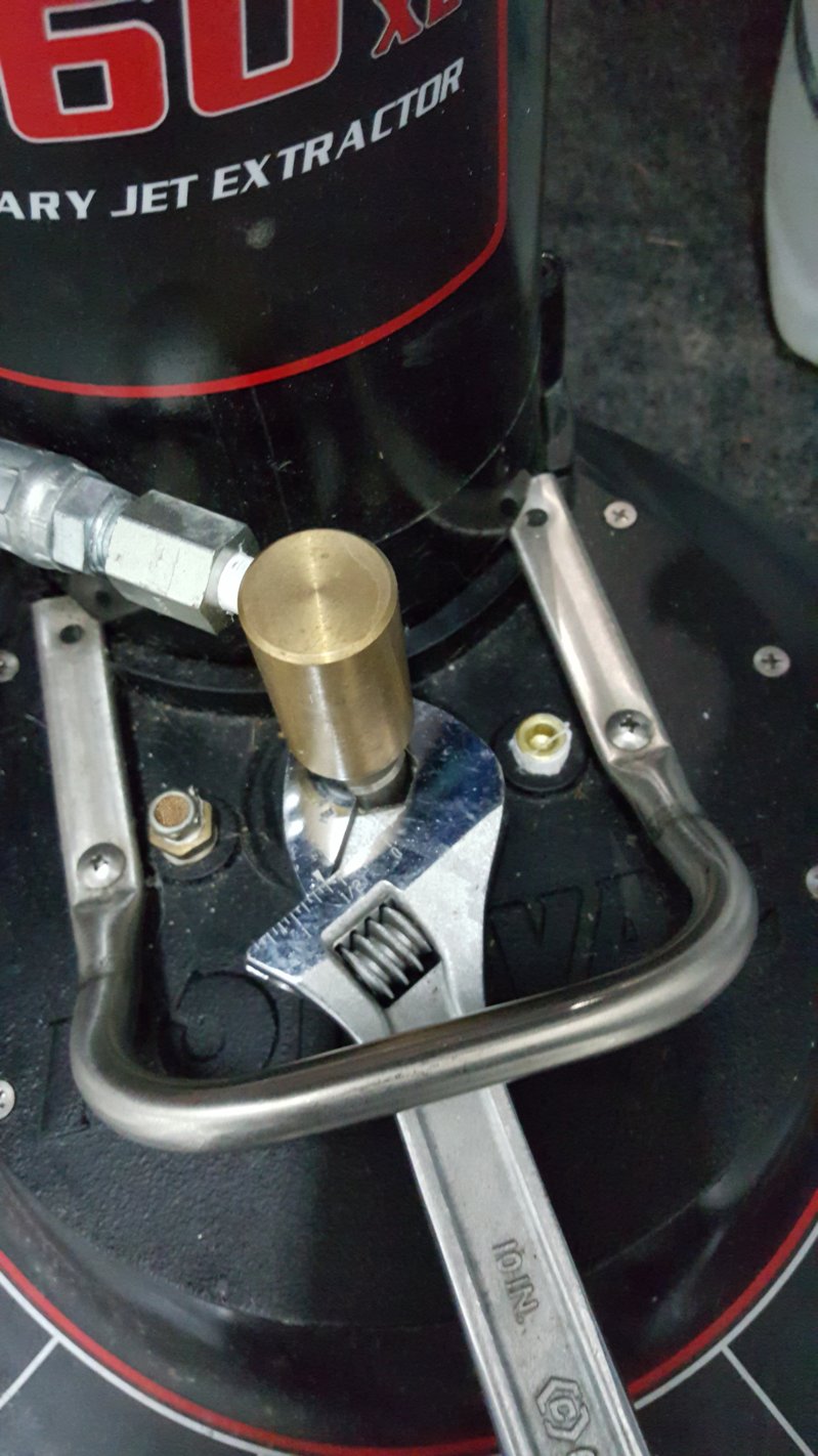

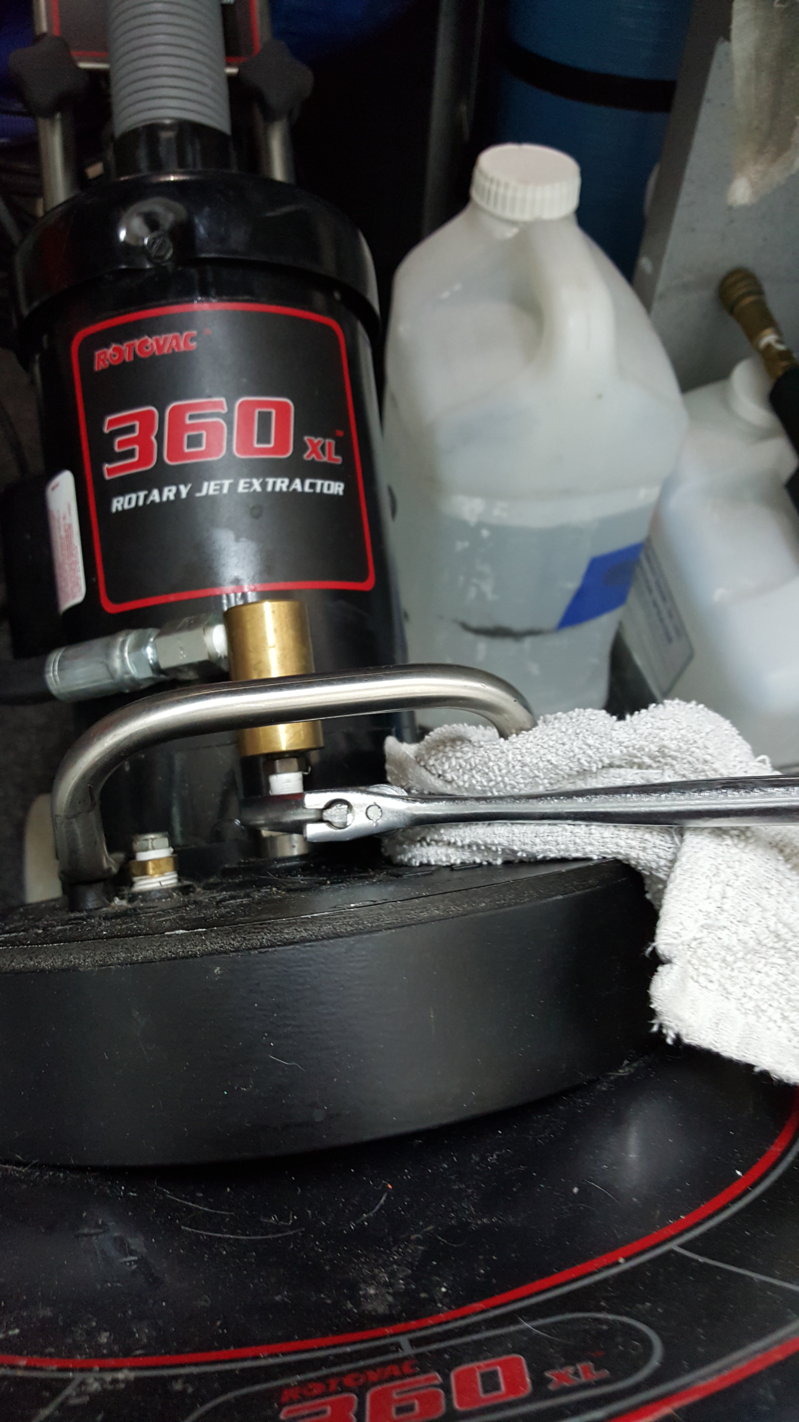

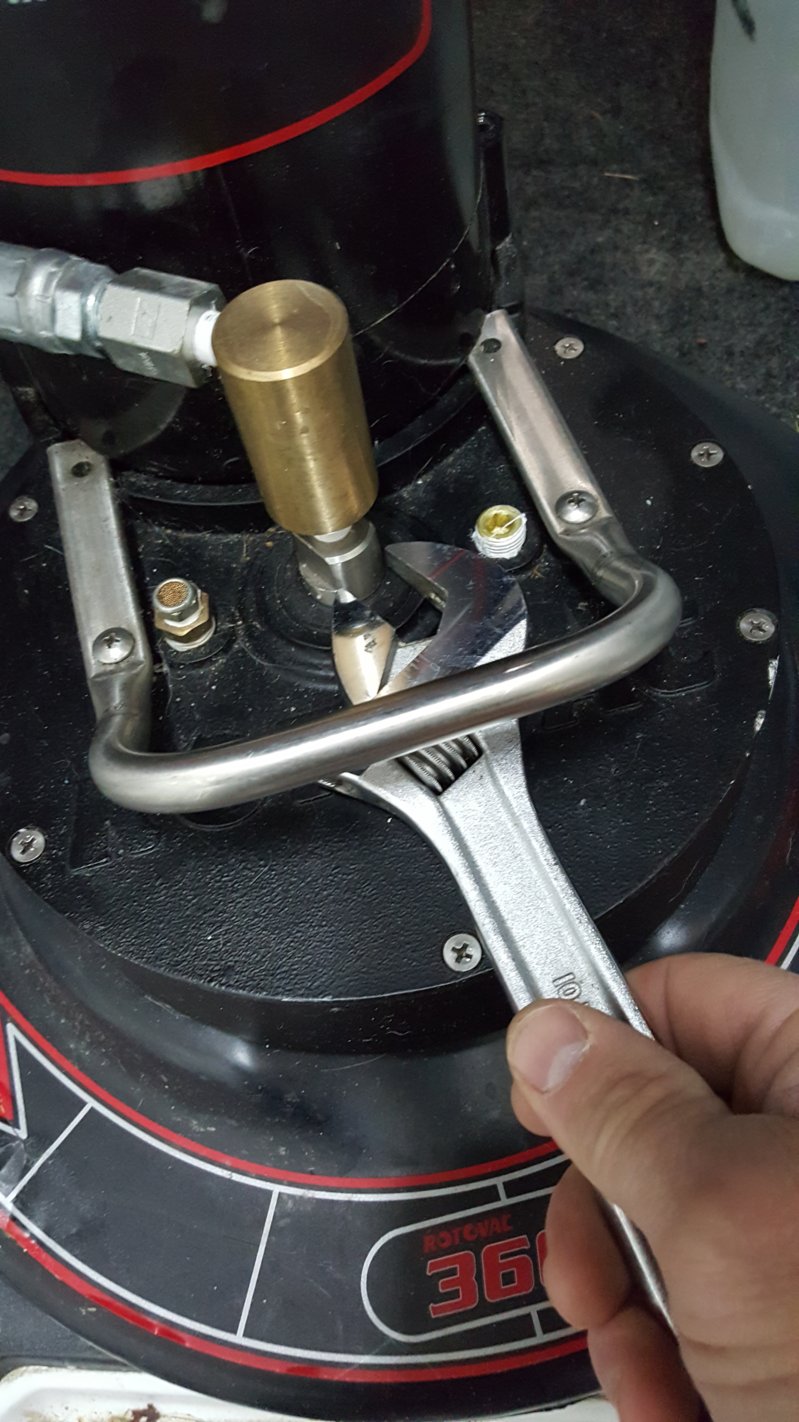

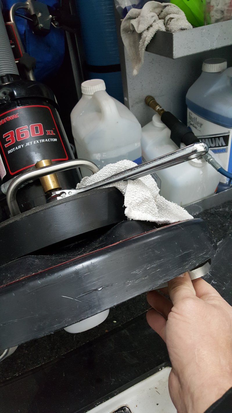

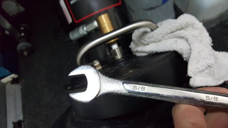

Here you go....
Especially with the Brush head with Nylon Glides, We have to do this...
5/8 inch wrench is better in my opinion that crescent wrench....
