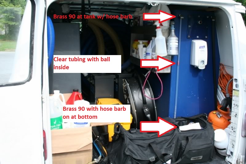

Empty tank, remove dump valve. After measuring, drill hole in top of pipe fitting valve screws into.
Drill similar hole in bottom of top fitting vacuum hose connects to. Insert matching barb fittings into each hole and attach clear tubing and float sight ball.

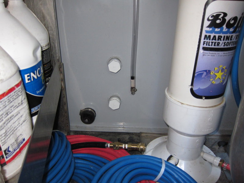

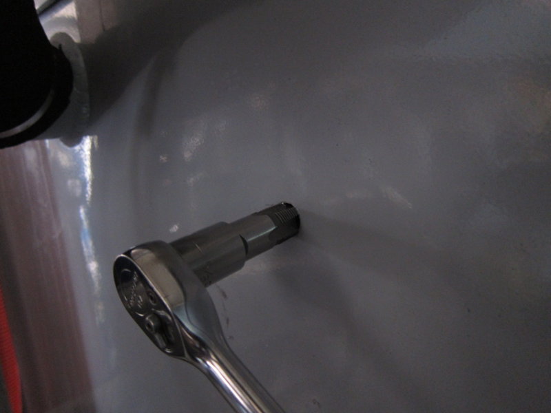

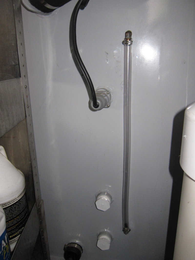

pics of installing a sight tube on waste tank. You need a 9/16" drill, 3/8" pipe tap, tap handle or socket and ratchet, 1/2"barbX3/8"mpt elbow, 1/2"i.d. clear hose (thick) and a float. For a float I sniped off a piece of 3/8" black thermoplastic hose. If you're nervous about cutting threads, practice on piece of scrap the same thickness of your tank. Then no guessing on level of waste.
3:8pipetap.JPG 1:2i.d.tube.JPG 1:2barb3:8mptElbow.JPG
