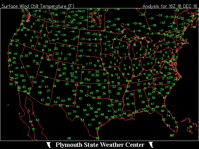

But we can throw a lot of that out the window RIGHT NOW...we have to do GORILLA freeze-proofing...No Joke...you need to do this right now if you live in the storm area...Check out the updated chill map for today...
The big problem today is a lot of areas are losing power...I just got a call from a friend where it is really cold...and we discussed the gorilla method of winterproofing your van...if the power goes out and you have no way to heat it...
