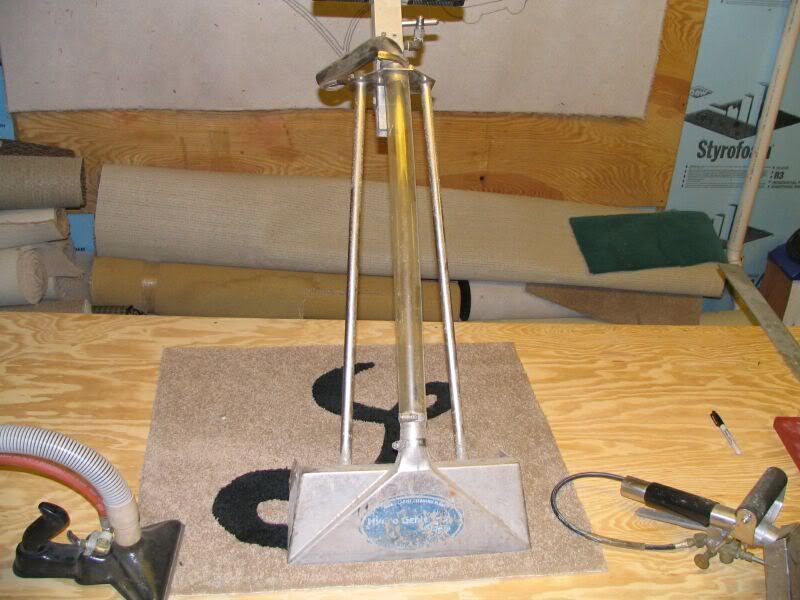

drag wand, what is a drag wand? somone send me a pic.

thanks for the explanation and the pic. never saw one like that before. i do have a power head that is 14inches wide that weighs like 50 pounds. i could see how it could wear ya out.

Here is a picture of the one I still have left.
People love to see the dirt coming up the clear tube.
