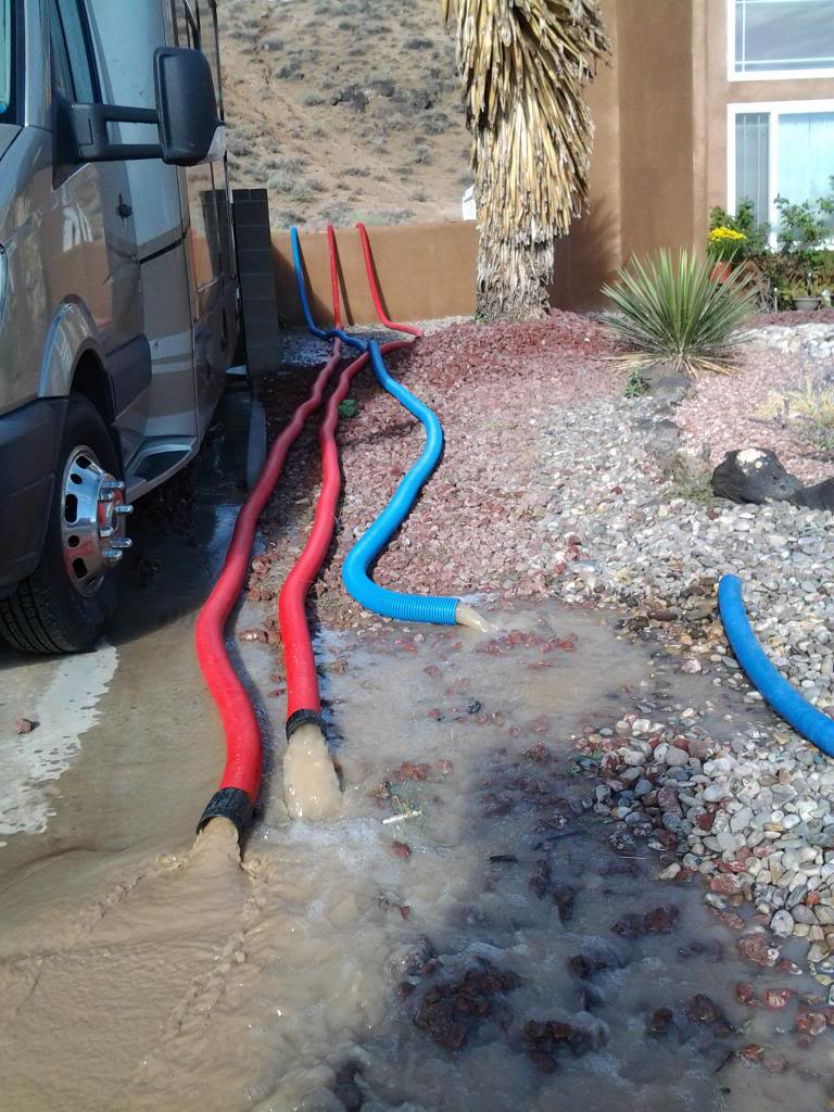

i created a natural siphon to drain the lake in their backyard.

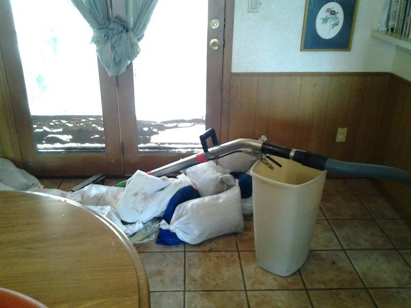

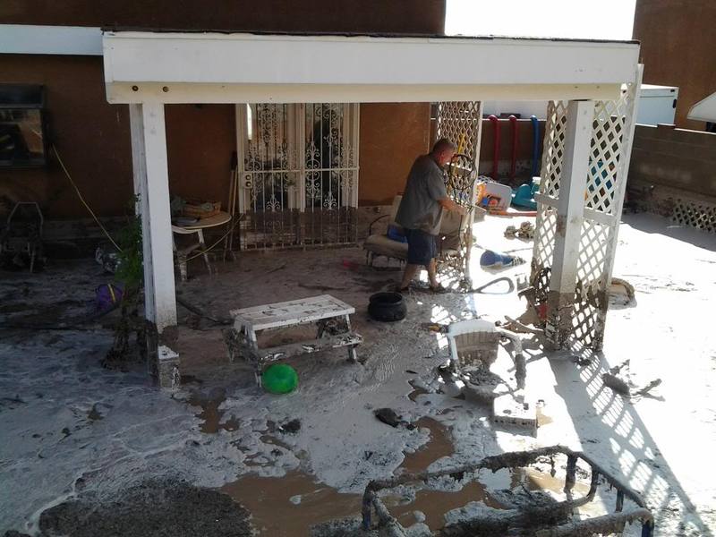

you can see the waterline almost 3 feet up the wall

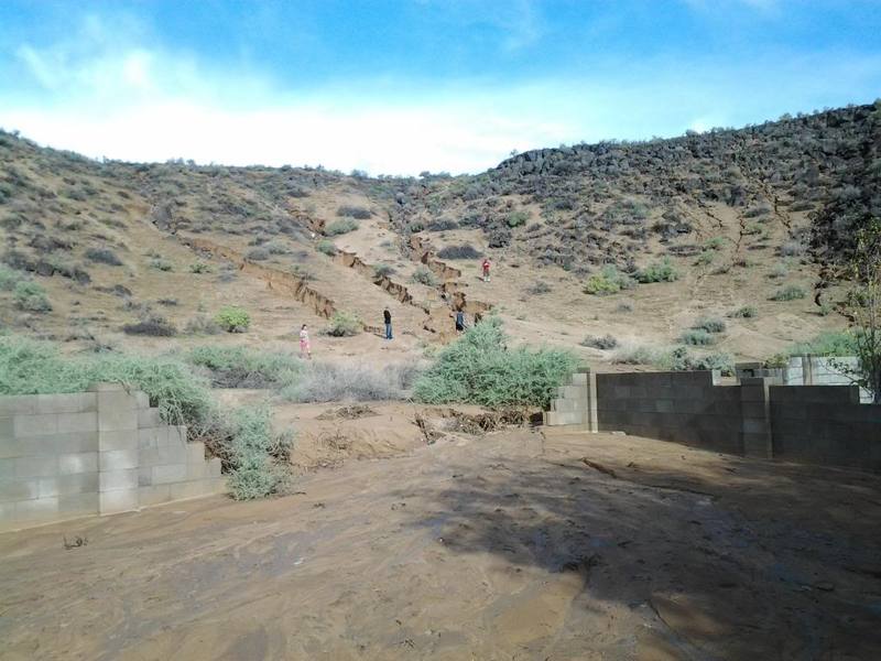

rain washed mud down the volcano cliffs and smashed through the retaining wall.

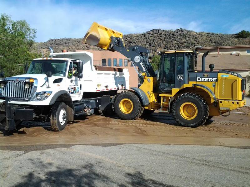

city workers showed up with heavy equipment
slurped up water as it ran through the doors.

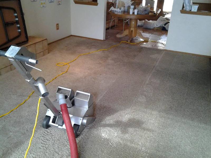

finally, a couple quick passes w/ the Lochhardt special extreme extractor.
that's all they wanted me to do then they paid and sent me packing. i think they have another crew lined up for tomorrow.

i used vacuum from the truckmount to start the siphon and gravity did the rest.
enough water got into the house to ruin the carpet and wet the baseboards. I extracted the carpet to make removal a little easier for them.
