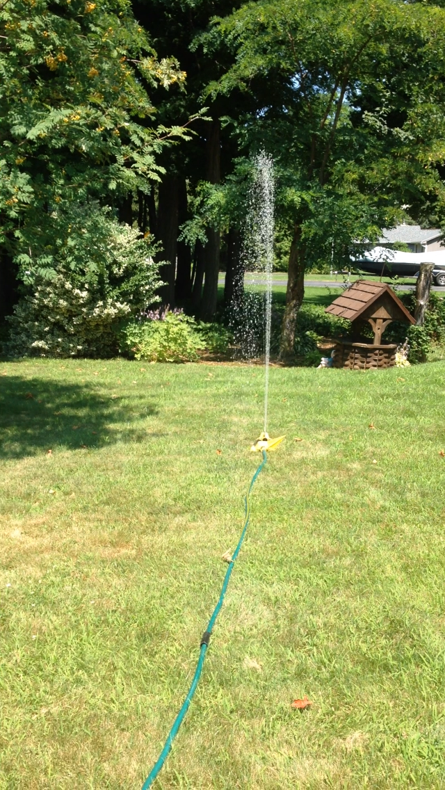

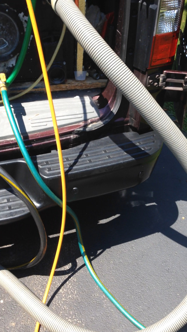

You could water lawns through the day then pump out when you get back to the shop via sprinkler system .. although some of yous use some pretty toxic stuff !! That should really be running through a sewer system for a cleaning !! Otherwise our ground water absorbs it !!
if you use microban sanitizer, or any other sanitizers it will kill the beneficial bacteria and fungi in your lawn and eventually kill it. But if your not, expect to mow alot.
