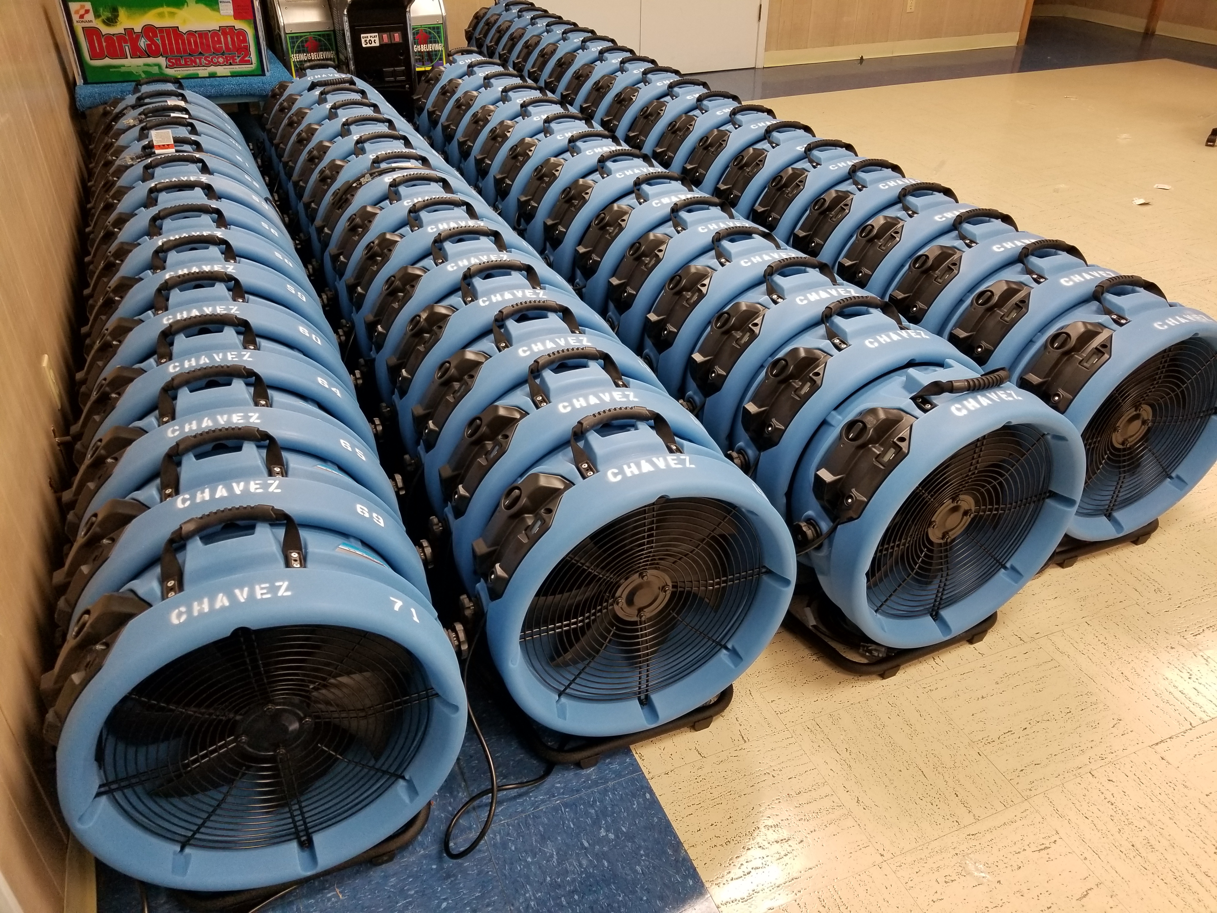

Decided to start with 2 of these
1/3 hp, 3600 cfm. Well see how they work out price is pretty good

hmm maybe cant link amazon stuff on here.. they are on amazon if you search XPOWER X47-ATR they have a few sizes, 1/2HP for $199, 1/3HP for $319. They are similar design to the ones Desk Jockey showed a pic of... they can aim straight down or in any direction.
