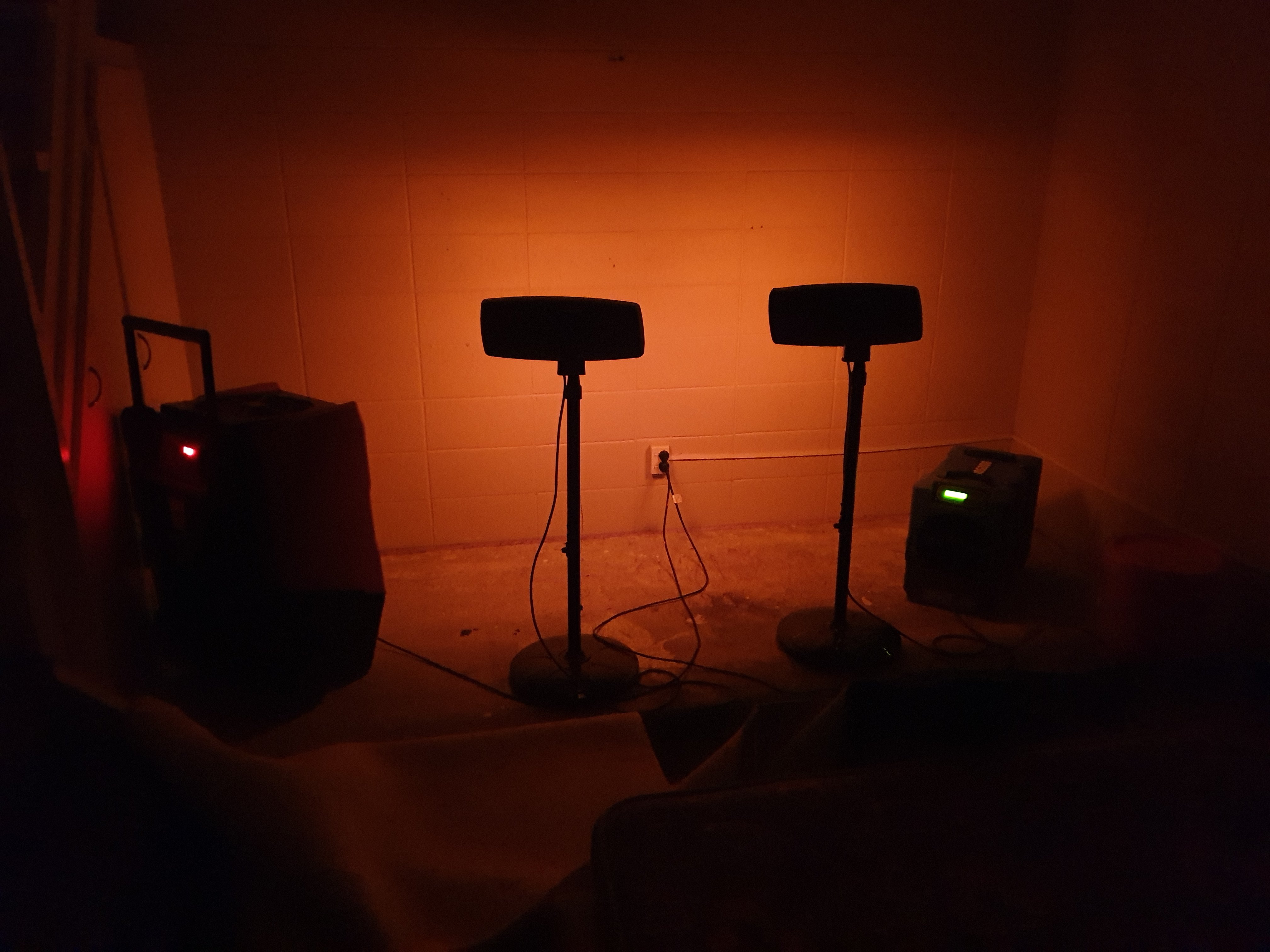

Got a below ground bedroom with cinder block walls.
Had water toby above leak which took couples days before it started coming through one of the walls.
That wall was at 6% and rest of walls were 1.5-2% (tramex cmex meter) been drying few days and that wall is sitting at 3%
I know you can take wood to within 4% of dry standard and then let it find equilibrium
But I got no idea on concrete cinder blocks?
Any thoughts/suggestions?
cheers

This has been ongoing, the loss adjuster told me to pull my gear out last week without looking at it because the home owner said it was dry...
met him onsite and showed him its still sitting at 4.8% along bottom half of that wall today vs 1.5% rest of the room :icon_rolleyes:
and we're drying again..
Hack Attack
Dec 19, 2017
5,620
further south than you
Dan
Just checked it, got the room at 89°F and 22% RH the wall is sitting at 112°
I was thinking of drilling as they are wanting to line it out at some stage, being a painted surface isn't doing any favours
Hack Attack
Dec 19, 2017
5,620
Dan
Still pulling water out, 15 liters so far... 💩
room is at 93°F and Rh 16% and moisture meter is sitting at 3% on that wall *(113°F surface temp)
spoke to a builder who reckons the bigger problem is the waterproofing has failed on that wall
cos Im a total noob using heat, do you try and balance the heat with the dehu or just crank the heat??
Im running 1 drieaz revolution and a phoenix r200 with the heat bypass removed which is recommended above 90°

Delhi???? You are just drawing moisture in from the ground.... 😂😂😂
Drill it, drain it, heat it...
