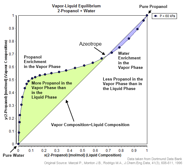

It will evaporate faster than water. Depending on the conditions*** we are talking about it is very unlikely to speed up the evaporation of other liquids (water) in a carpet cleaning situation. Especially a quarter cup. Any decrease in drying times would be due to displacing a slower evaporating liquid.
***It's a little more complicated than that though:
In your case though you are increasing the volume of liquid rather than displacing another
in chems it is likely used more for it's solvent and sanitizing properties although the faster evap could be of benefit

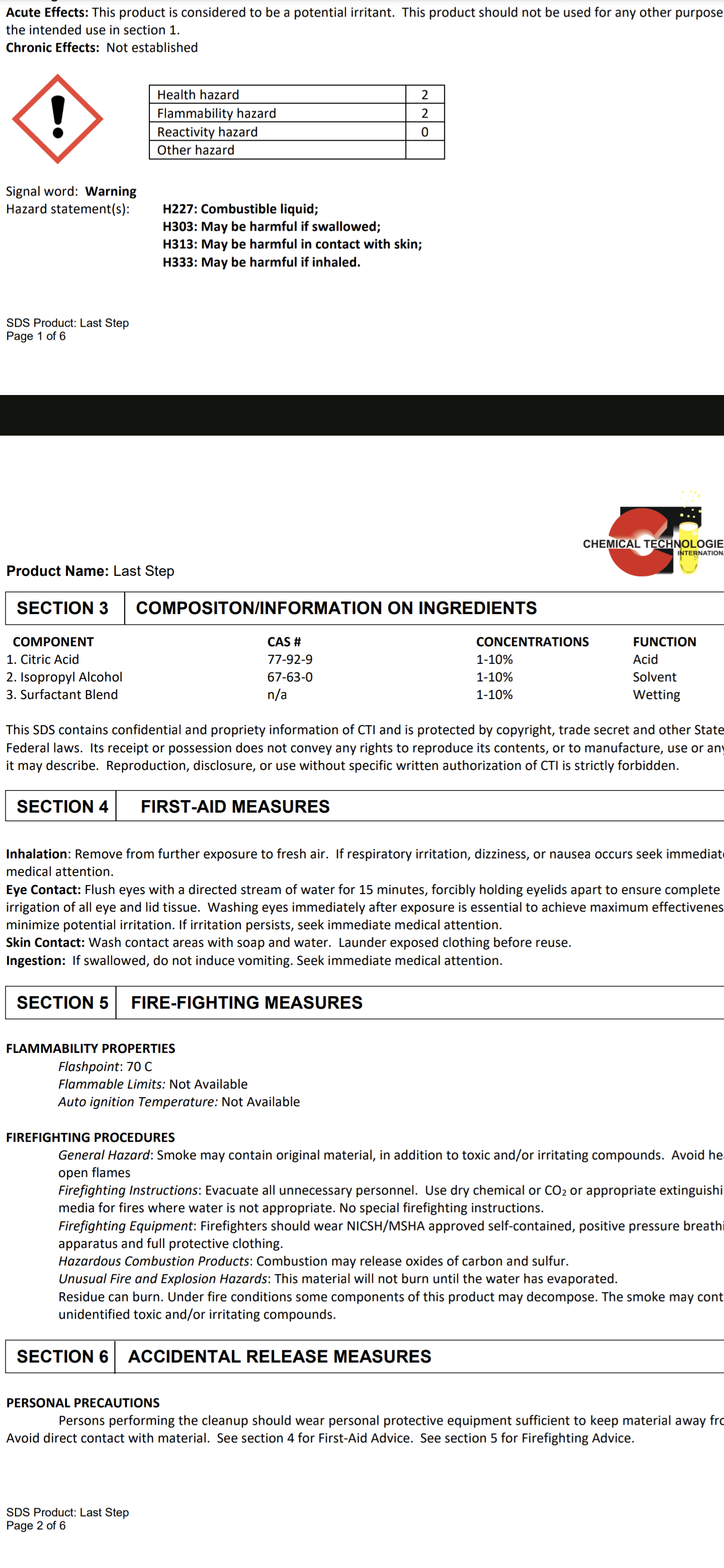

Lea put alcohol in 02 rinse CTI uses it in last step rinse. I believe prochem used it too.

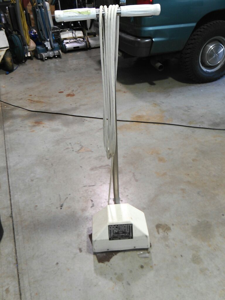

Didn't they have a square pad machine at one time?
Reactions: Jim Pemberton
Village Idiot
Jul 13, 2011
26,366

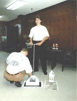

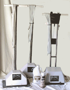

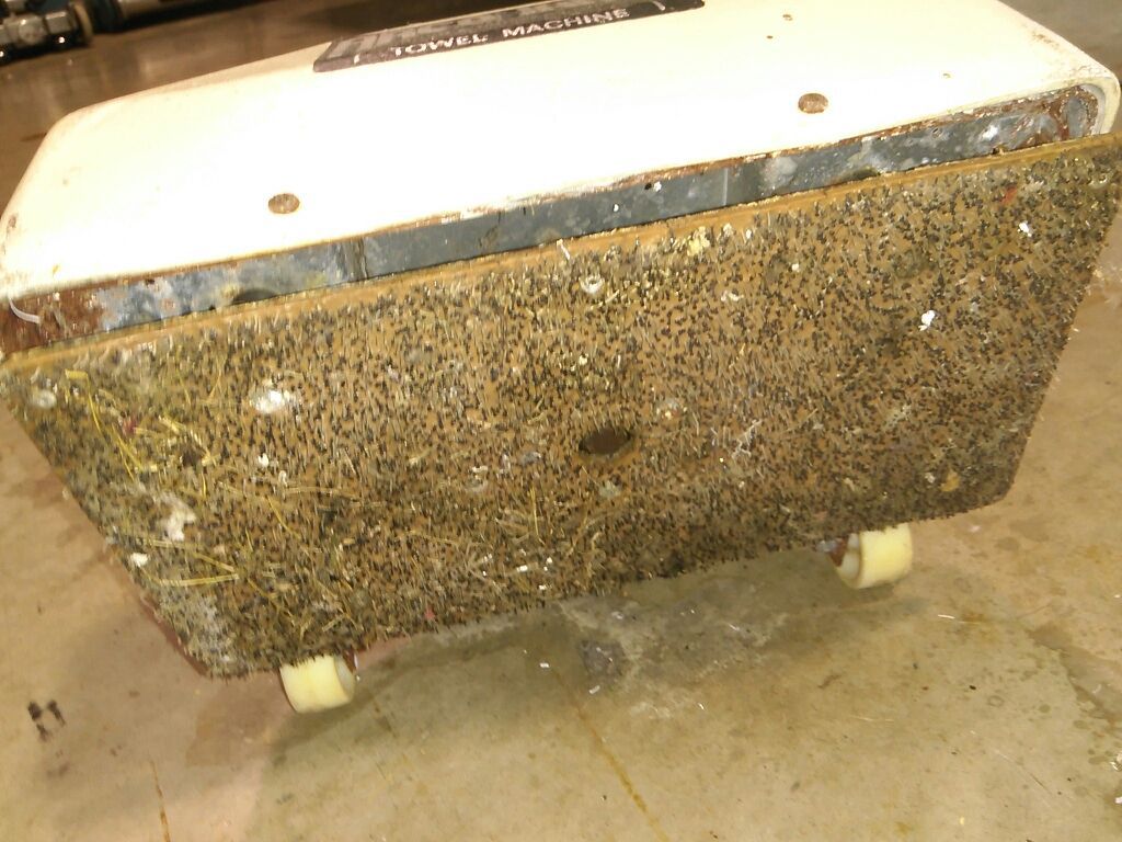

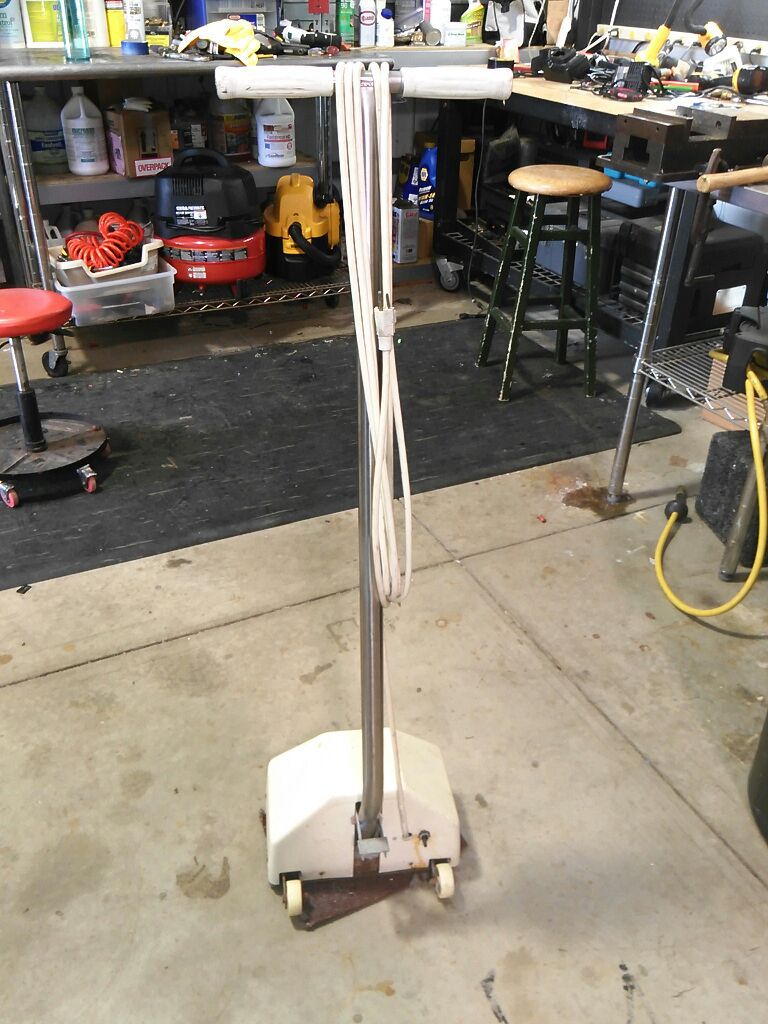

Yes...argonaut
ARGONAUT PLUS TOWEL MACHINE
Reciprocating motion 16 1/4" x 10" stationary pad holder 15 pounds, 115 volt, 1/8 hp motor, 5 amp , 1700 rpm free. Use with ARGOSHEEN and all cotton pads for removal of soil. Also available with 220 volt motor for Europe.
ARGONAUT SUPER TOWEL MACHINE
Reciprocating motion 10" x 12" or 16 1/4" x 10" stationary pad holder, 35 pounds, 115 volt, 1/4 hp single phase motor, 5.6 amp , 1725 rpm. Use with ARGOSHEEN and all cotton pads for removal of soil. Also available with 220 volt motor for Europe.
Yes.
My father bought into a lot of early innovations...not all of them worthwhile.
He did well with Argosheen for awhile when he wanted to improve over shampoo and avoid “steam cleaning”.
Back then people thought if your stuff smelled like a toxic waste dump, it must be really good.
