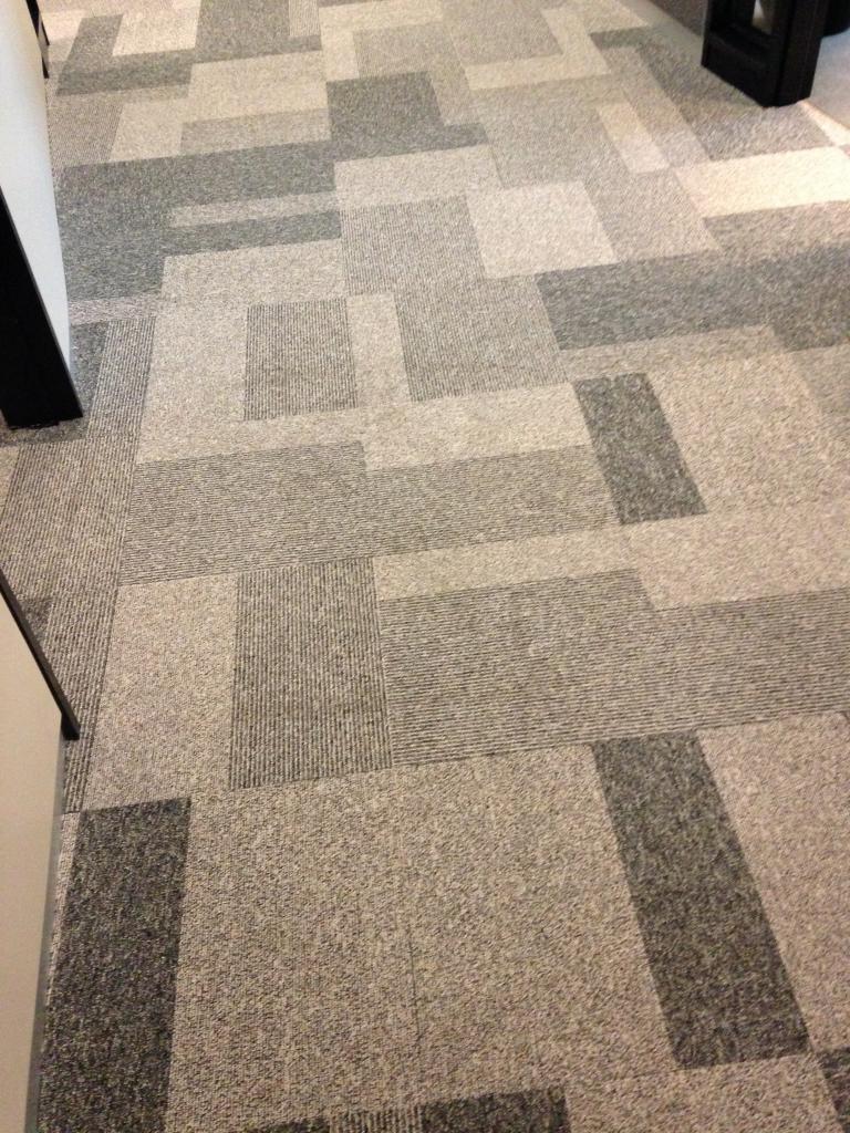

Doesn't look too bad to me.

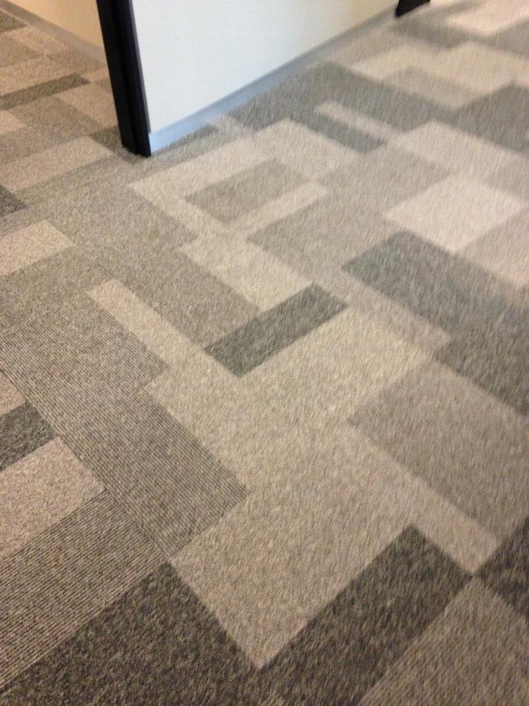

Shane Deubell
Jun 30, 2011
4,052
Thanks scott and mikeysboarders!
Went with avenge pro but brought the other stuff just in case.
This was the clients response this morning.
I love it when clients want to pay me as soon as possible :headbang:
Hi Shane,
I think the carpet looks really good! Thank you again. Please reference PO# ----on the invoice for this work. Are you able to send me the invoice via email? I want to make sure we get it processed for payment as soon as possible.
