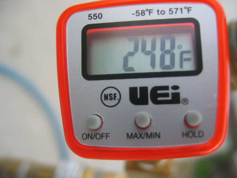

You know who you are. Thanks for the 3HT tweak. The ti wand was peeing like my 1 yr old grandson with no diaper on, thing didn't know when to stop.
All I can say is a little information can be dangerous, I love it!
Greenie
6,820
248 at the wand.....be careful.
If you have that heat potential, and you don't mind burning an extra gal of fuel per day, then consider a wand jet upsize, that way you can run in the 220-230 deg range and have a little more flushing power and save your solution lines.
It's nice to have real heat for sure, but real heat matched with real flow is amazing.
