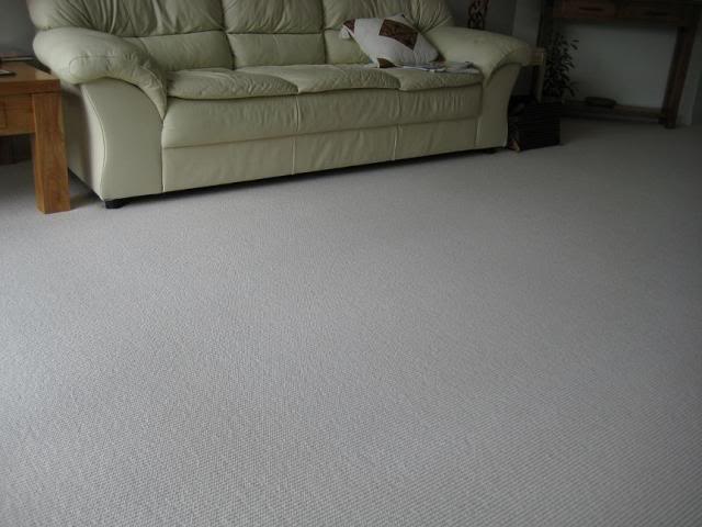

PS::::: Is it something like this ------------ 2536_33_zpsdf0d94de.jpg

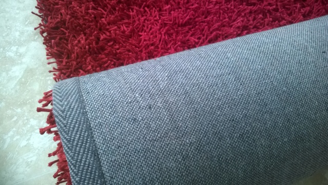

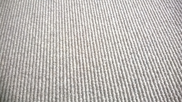

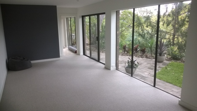

Here are some photos as requested Shorty - photos of the room (lots of natural light), the carpet, and the offending rug. I don't have a photo of the stain as that carpet has since been replaced by the supplier due to a manufacturing defect. As it turns out the new carpet has more defects than the one they replaced, but you can't really see them in the photo. Any thoughts on how we could use this type of rug on this type of carpet would be appreciated.
Hi Darren,
first up, let me say that I am in no way an expert on carpet or rug fibres and I welcome the opportunity to hear from those much more experienced than I, as I also like to learn more.
I believe that the problem is not with the carpet, it is with the construction of the rug.
To me, this appears to be a Chinese Polyester with a LATEX backing, & I believe, herein lies the problem.
The Latex off-gassing from the rug, causes a chemical re-action with the carpet fibre, whatever that may be.
In short, I do not believe than this rug can safely be left on any carpet without there being an adverse re-action between the rug and the carpet.
Again, I reiterate that I am not so knowledgeable in this department, and would ask others to please help with this problem so that we may all benefit a bit more.
Thank you.
:yoda:
PS::: When you next visit this property, get down on your hands and knees, breathe out, lift the rug and get a real good lungfull of the back of the rug through your nose.
If you smell rubber, it most likely has latex holding all the crap together, until it starts to break down and little wisps float across the carpet.
On a hot day, with all the windows closed you, will smell the rubber/latex, as soon as you walk into the room.

Seeing the photo of the rug, another possible cause could be transfer of excess dyes crocking from the rug. I would wash to rug once or twice to remove excess dye. Then treat with Dye-Loc or similar to assist in stabilizing dyes.
Thanks Scott. What doesn't make sense to me though is the rug is red, the base of the rug is blue, but the discoloration was yellow (almost identical to the photo posted above by Shorty) In my unqualified opinion it seems to support the off-gassing theory rather than dye transfer.
I doubt that I will use the rug again on carpet, but now I am very dubious about using any rug on a carpet. Is there any sort of inert material that can be used to provide an effective barrier between rug and carpet?
