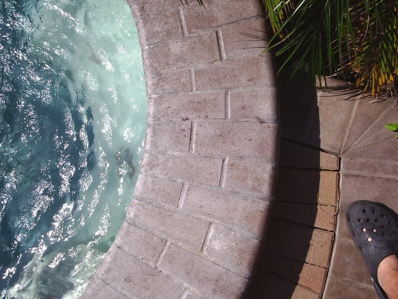

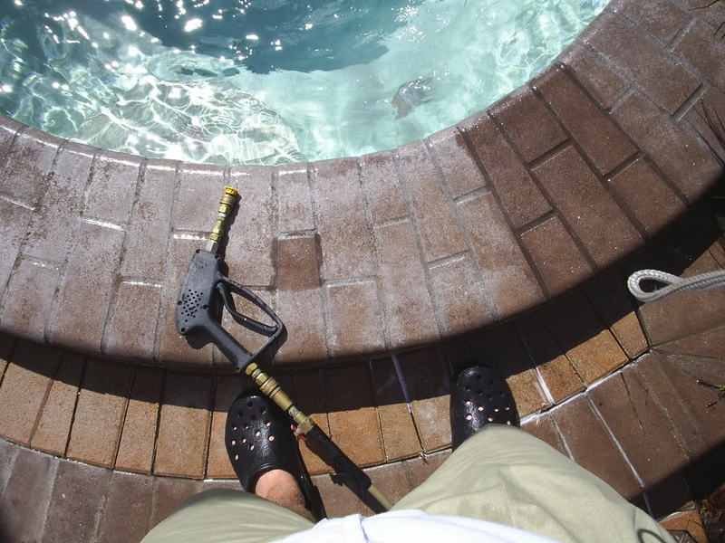

LIKE THIS..... :shock: Sealer was applied...before pavers were cured..... :(
