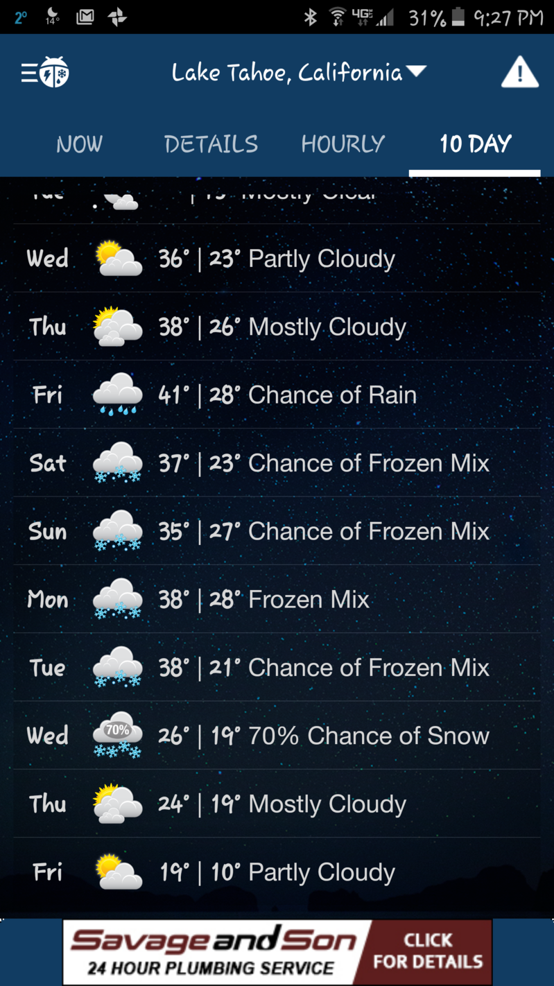

What sustained day time temps does it take to freeze equipment?
Today..
Got a job up at the lake on Saturday...
Hope them Texas tires work..
