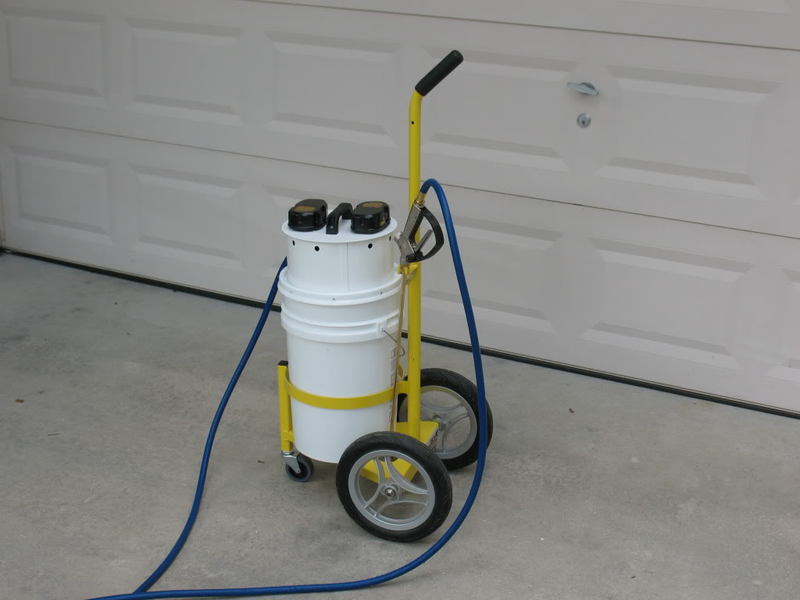

Does anyone know the gpm for some of the electric sprayers out there?
This is the sprayer that I am working now. I have used it for some outdoor applications that we do, but will be testing next week indoors for carpet. It gives out 1 gpm.
The top part sits on top of the bucket (3-7 gal). So you can mix up different solutions and keep them in their own buckets. It has a 25 ft hose.

2 - 18 volt dewalts.
That is my favorite part of the sprayer. You get a lot of usage and you can keep 2 spares with you at all times.
We plan to use this on big commercial jobs where prespray is necessary for portables or CRB machines for encap. We can place 5 gal pals along the halls for easy refill and keep trucking on.

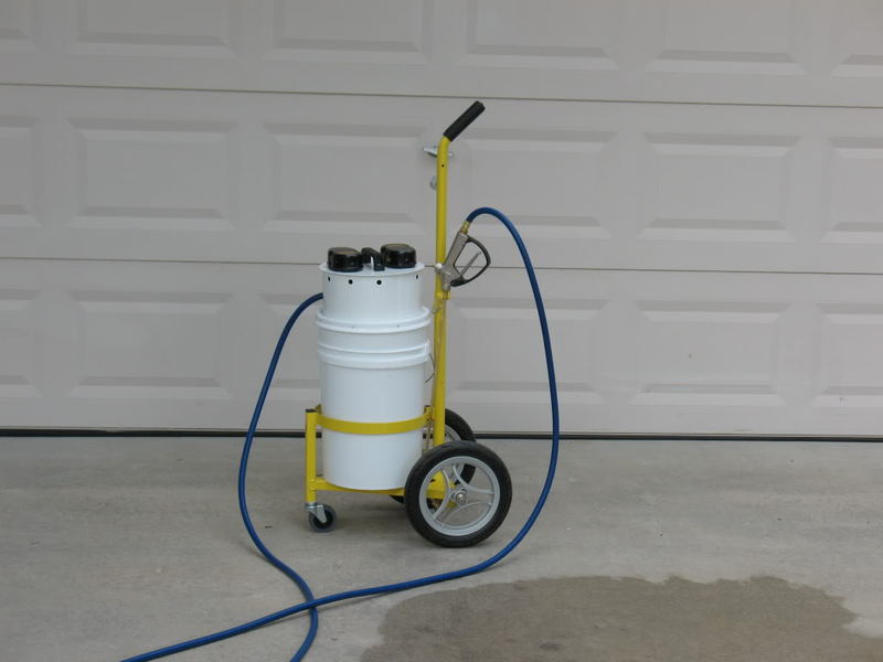

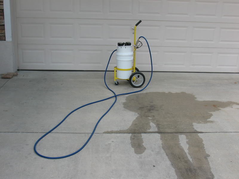

It is a 12 volt shurflow pump. The 18 volts drop down to 14 volts pretty quickly to a steady flow to the pump. I am not a pump or electrical expert.
We use the sprayer when cleaning and sealing pavers outdoor. I never pushed the issue until I was trying to set up a very large commercial job that was going to need to be all presprayed.
I am going to put it to the test over next few weeks to see how it performs. I really like the battery setup, since that is what I have struggled with on my omni for a while. It probably puts out too much for protector, but will use a pump up for that.
