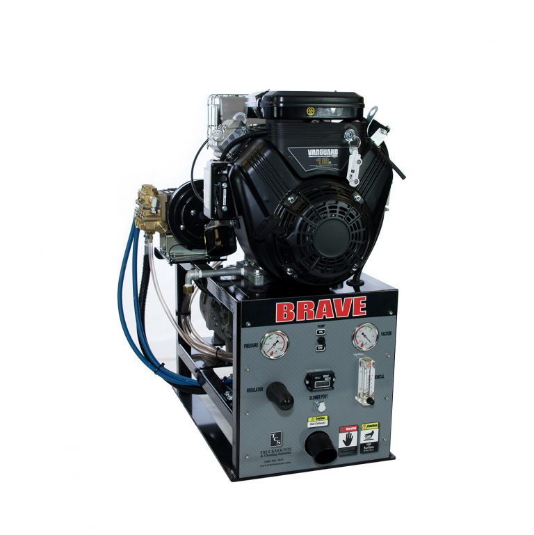

how much is this TCS TM????
and how much will a plastibox porty vac in van cost with a big enough GAS generator and heater??
bet it's not all that much less than a more powerful Little Injun ...and WAY smaller package to boot
