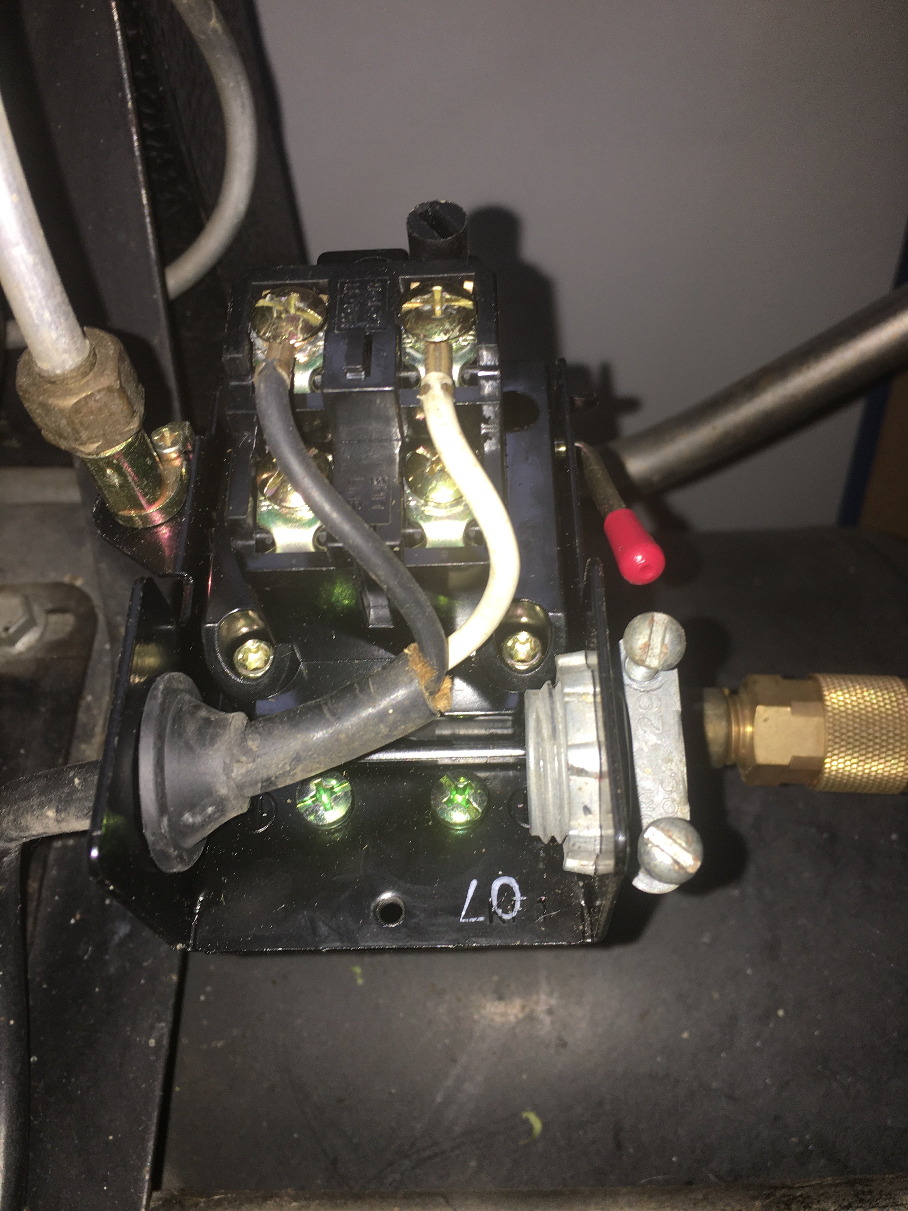

I have an air compressor with a 15-amp, 230-V motor.
I have a generator with a 220-V outlet, configured as shown in the picture.
Here is my question: The compressor motor has two wires from the motor to the switch terminal. There are two screw terminals, each marked “line” and a ground terminal.
So, from the plug, the L-shaped prong is ground. Which two of the other three prongs should go to the “line” terminals on the motor?
I have a severe aversion to things blowing up in my face. Can you help?
View attachment 97899 View attachment 97900

What if there is no neutral terminal on the compressor motor? Do I just hook up two hots? The two top terminals are labeled “motor” and the two below are labeled “line.” The green is ground, obviously. But there is no neutral from the motor. Does ground suffice for the neutral?

Okay.... Inspired by the general confusion, I looked it up. Turns out that for 220-240, one ignores the neutral line altogether. So, 10 gauge wire, make up to the generator plug on the two hots and simply let ground be ground. To the compressor, hardwire the two hots and ground, light ‘er off and see what happens.
