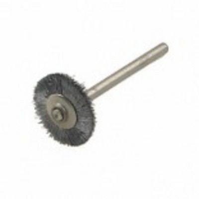

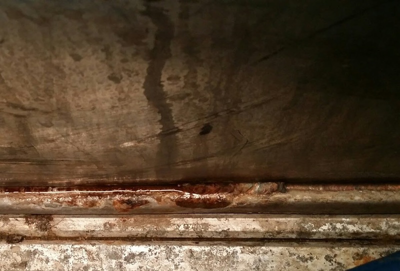

May 4, 2016 #34 Goomer Member Joined Feb 9, 2009 Messages 3,398 Name Frank Mendo Mikey P said: View attachment 14348 Click to expand... Most good metal epoxies like regular JB or JB Water Weld will seal it. The key is to correctly prep the surface by bringing it down to clean metal with a small wire wheel like the ones on a Dremel. http://www.homedepot.com/p/Dremel-1-8-x-3-4-In-Carbon-Steel-Wheel-Brush-428/100034504 Dremel's are a must have. Reactions: Mike Pailliotet
