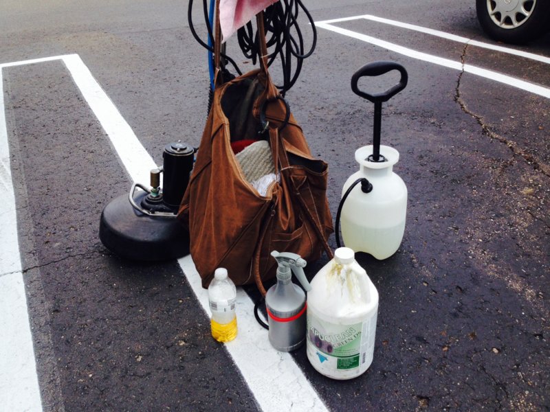

Had a job this summer, guy wanted his office done at 4 pm on a weekday. I thought it was going to be a strip mall office I could blast through with my TM. Turned out to be a PIA 7th floor office. His Coworker was left there and just wanted to know "how long is this gonna take?" I was just going to decline the job once I saw what it was and how long it would take to set up a portable,get the OK from security etc, then I remembered I had some Ecapuclean Green and thought I would give this a shot. I loaded up a carry bag with a red ped and a few cotton bonnets and a quart bottle of the encapsulate concentrate and brought up my 3601 with a pad driver attached and a pump sprayer and took the elevator up the 7 floors all in one trip. I sprayed down the encrap, ran the red pad, then bonneted everything. I cleaned the whole office of 3 rooms lobby and hall and was done by 5 o'clock, instead of the 7 o'clock it would have taken to steam clean. spots and traffic lanes cleaned up great including the coffee spills in the eating area. Just thought I'd share this magical moment.
