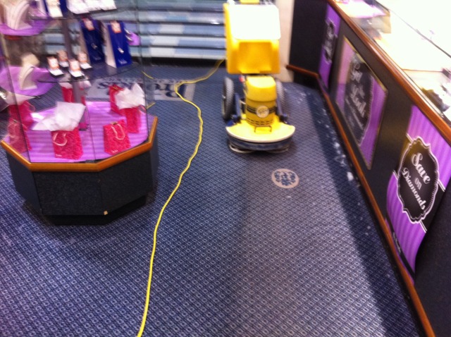

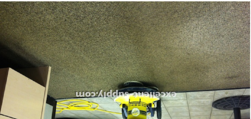

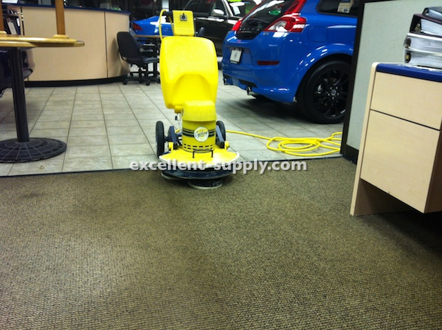

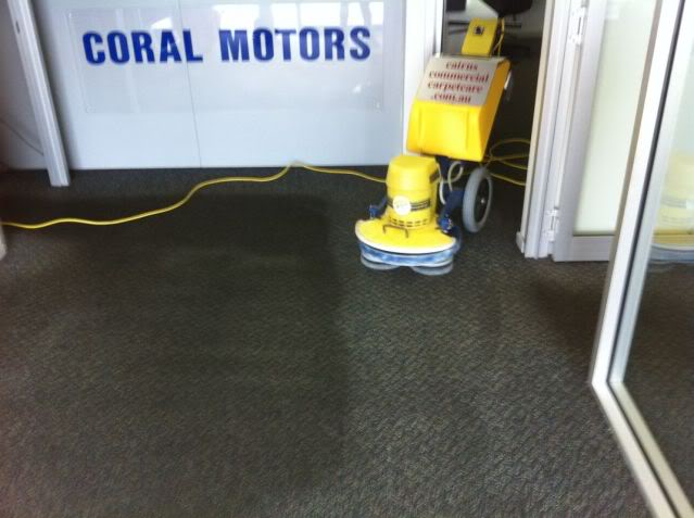

Truck dealership:
Jewellers store:
It is what it is...................

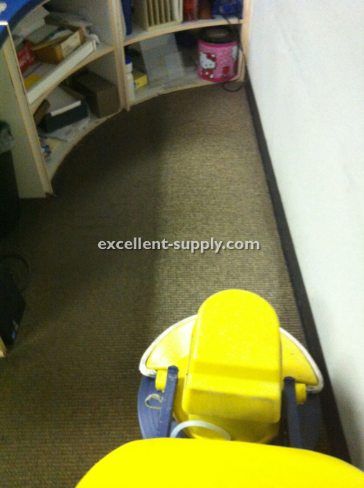

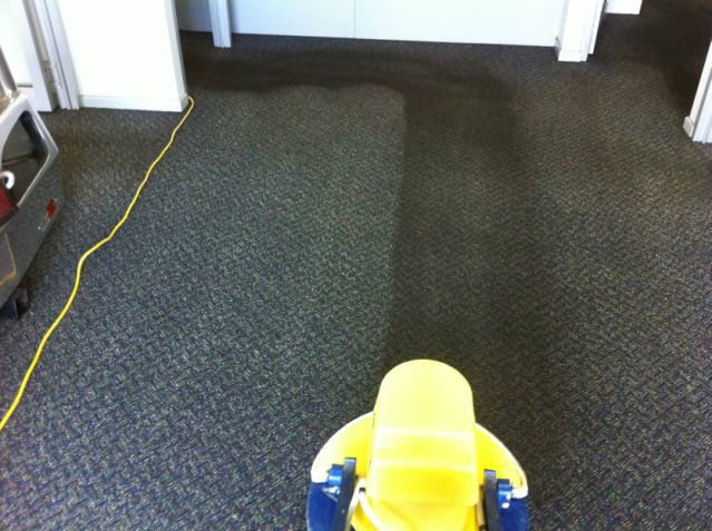

It can be done. Here's one I was on recently. Cimex, FiberPlus max, and Releasit Encap-Clean DS2. Took a little extra time scrubbing, because it was in such rough shape. Previous cleaner had done HWE on it the last time it was cleaned, and they said it looked terrible afterward. Everyone was impressed with the results with the Cimex/Releasit combo.
48,449
Prattville, Alabama
Not picking on Rick at all, but that particular picture shows some yellowing in the cleaned areas ... which can't be helped even with encapsulation cleaning some times. It's just not the best picture. In fact, I could make that carpet look just as good with a 175 prescrub and a HWE rinse.

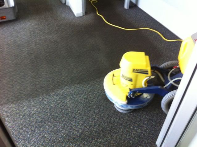

The carpet actually looked better in real life than my phone/photos showed.
Here's another shot from behind the counter at the same job.
I know these pics won't win any photo contests - sorry Marty.
