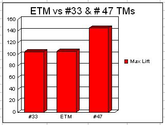

Average digital vac readings while extracting the same plush carpet were used on this graph:
The 16 HP #33 Blower TM & Escape ETM were essentially equal in performance,
while the 30 HP #47 Blower TM was ~37% more lift.

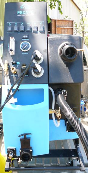

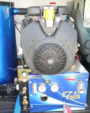

These are photos of two of the actual machines tested:

Larry, thanks for taking time to test
Those numbers are for lift only? No cfm
Did you do the test for recovering, and testing amount of water recovered?

The numbers we recorded "at the wand" were all using 100' of 2" vac hose,
and the 12" x2" Bentley wand, while the wand was cleaning.
We measured lift to 4 decimal places . . .
which is also related to actual CFM moving thru the entire system.
The machine with the highest lift while cleaning,
would also recover the greatest amount of water.
(which we didn't measure)

Some additional data:
CFM is related
to the actual lift measured at the wand while cleaning carpet.
Below Lift @ Sealed vs. Lift @ Wand Extracting Carpet
Machine -Lift Sealed - Lift @ 100' 2" Hose @ wand outlet
#33 TM - - - 215" - - - - 133" - 9.8" hg.
ETM - - - - - 217" - - - - 136" - 10" hg.
#47 TM - - - 215" - - - - 175" - 12.9" hg.
