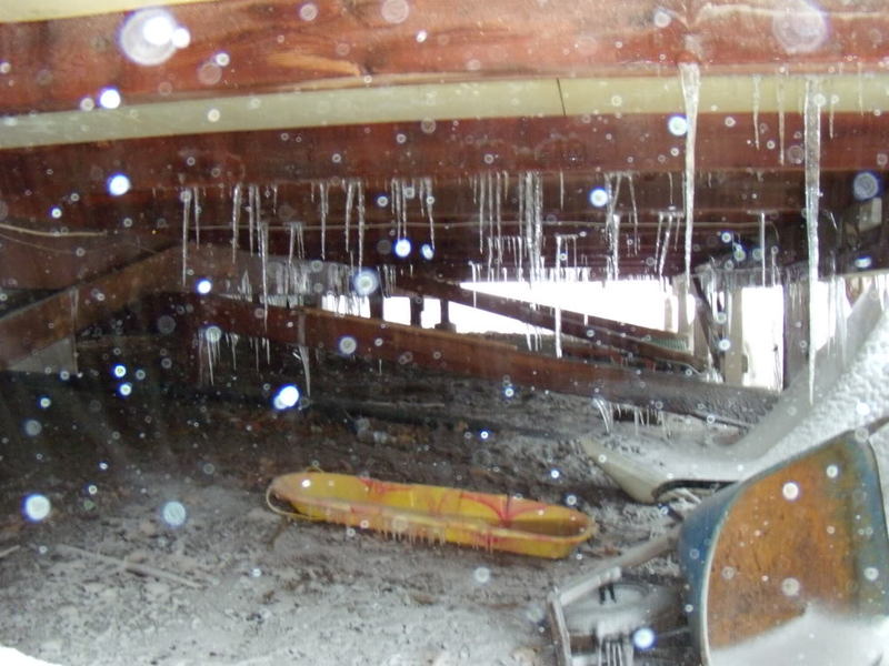

We got this due the amount of old cabins with no heat. Like this job it was 28 degrees inside.
