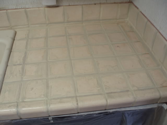

This guy didn't even know his grout was color sealed. The installer did it with out him knowing.
No idea why. The grout was fine.
The owner did buy one of the As Seen ON TV Grout Pens that dispense what looks like Type writer white out on some areas You can see in the first pic what a mess it was.

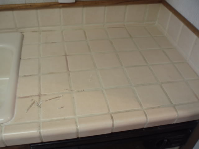

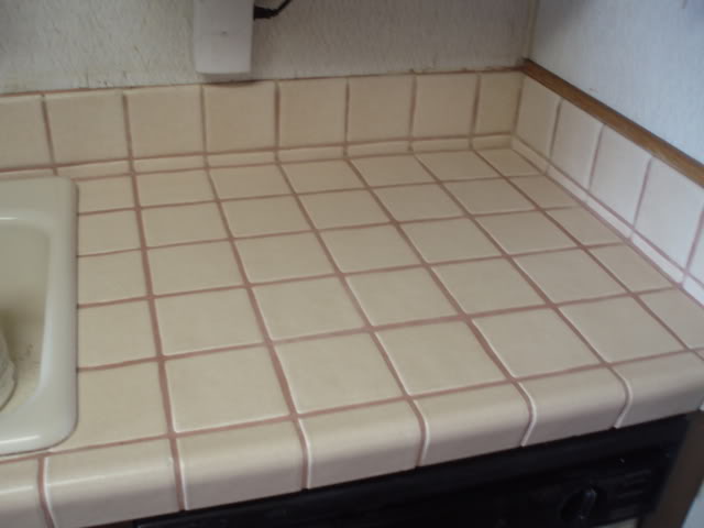

We used some non toxic gel based paint and varnish stripper, lots of bruches, a grout saw and a Cobra to get 99% of it off.
What a PITRFA!
At least he paid cash.
Gel at work..
As good as I could do with the amount he wanted to spend.

I did. I used bare bones on two different testings.
Second time let it dwell for over 45 mins having to keep applying product to keep it wet and aggitate by hand brush because of the small areas (40 sq ft). The tile edges were a real PIA.
We finally got it to respond with the dwell time. Small amount was left in the grout lines but after it dried we brushed the flakes off with a wire brush.
