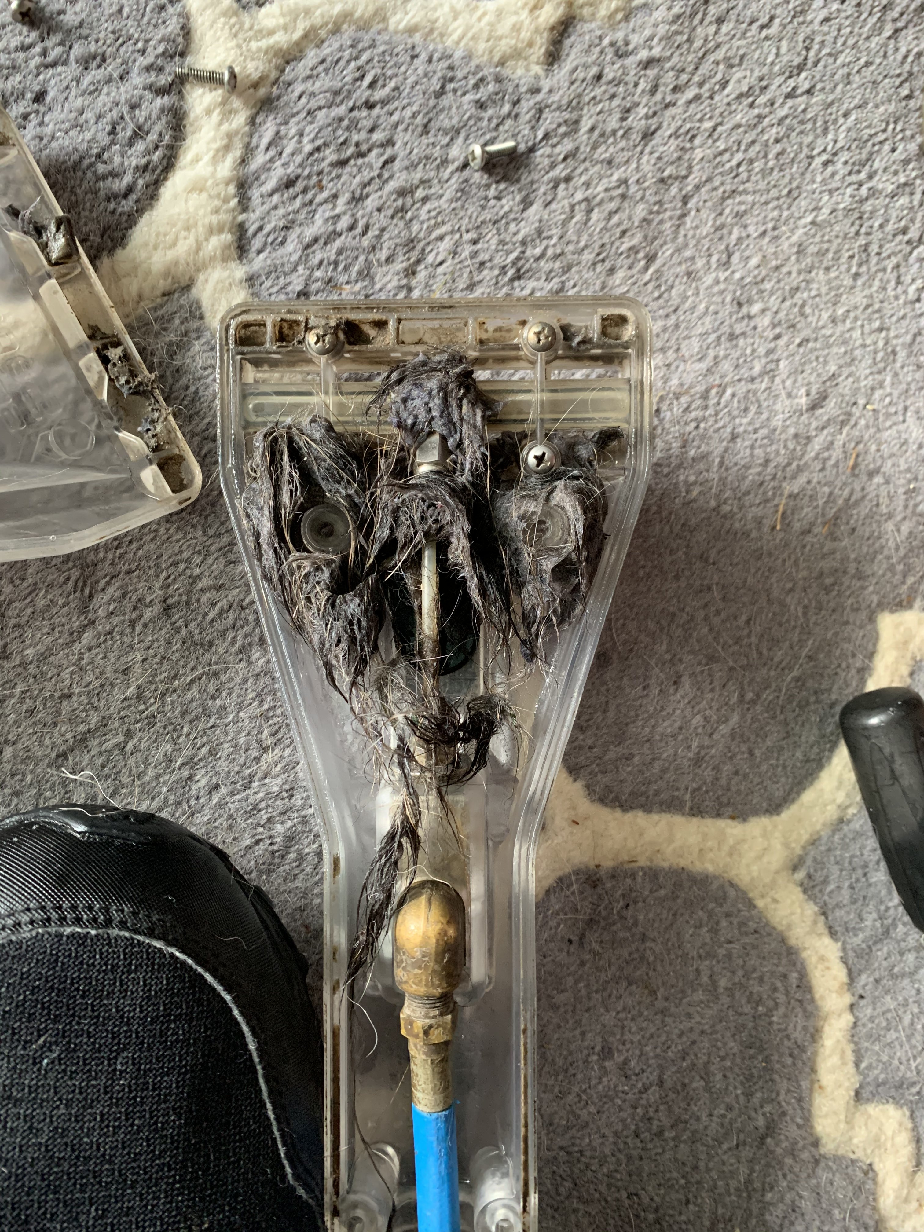

After a job while the gunk is still wet, I squeeze the hose cuff to an oval and vacuum the gunk back out through the slots and/or the vac relief hole. When there is enough to grab I pull on the pieces until I get most of it out. If a small piece refuses to come out, it will likely shift during the next use and come out then. I have never taken the tool apart.
