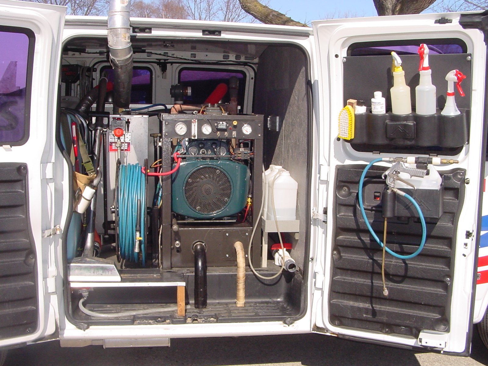

The large black pipe is the blower, has a 90 degree under van to another muffler. The small pipe is engine exhaust, it also has a 90 that directs the exhaust to the other side of the van.

I love that van, the only issue is that is a standard length van. When first bought my PlowerClean Victory it was rear mounted in this van but with all the issues I had on the Victory it made it too difficult to work on. It was also very tail heavy with that 110 gallon freshy and the unit in the back. Now with this back up unit in, it is very easy to clean out the waste tank
