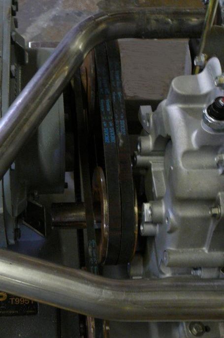

I recently swapped out my old tired Onan 24hp for a shiny new Kohler 28hp water cooled. The switching of things went smooth, but I gots me a problem of biblical proportions.
When I ran it the other day, after about 1/2 an hour I went out and checked things over, and noticed my exhaust was glowing bright red.
I changed a few things today, to try and give it better flow through the pipe.
Does anyone have any thoughts of why this would be happening?
Things to consider:
-It's 1" pipe all the way from the engine to the HX.
-The Onan has a higher displacement than the Kohler but never had this problem.
-The Kohler runs at a higher RPM... more output?
-I have welded the exhaust a lot, so that might my issue, with internal restrictions and what-not.
I am to the point of scrapping the whole exhaust and making something new with smoother bends.
Any ideas from the Gurus??
Thanks a MILLION!!
Erick
PS. It's in a early 90's Prochem Bruin (non-catalytic)

We use a lot of Kohler engines on our TMs and the red glow is common on brand new exhaust pipes.
After a few hundred hours or so, the carbon build-up will slightly insulate the pipe. The operating temp will go down some.
1" pipe is fairly small. We use 1.5" SS tubing for the main tube in our headers:
Do you have any right-angle joints in the header??

blockage somewhere giving you restriction...causing the heat build-up
had that problem, till i found the blockage and took it out....which in turn i took out the exchanger..but i have a rippen lp burner so i didnt care...
now no more red for me...and the damn motor pulls a lot better

I have the newer 36 hp Kohler and the entire muffler was glowing bright red at night. I called kohler and they mentioned the fact that it had a fixed jet 2 bbl carb setup that was set rather lean from the factory for EPA reasons. They sent me a new carb at no charge and it helped a little bit but after long jobs ( 4 hours or longer) it still glows a little bit. After talking to a few kohler owners it is not that unusual because most kohlers run alot higher exhaust temps.

These things are glowing like they are fresh from a blast furnace. even during the day it's scary as hell. At night, it's insane.
I got an area with some 90 degree bends on it (near the Y of the pipes). and I know for a fact there's some serious restrictions with the welding I did on it trying to get it to fit.
I will keep ya updated as this progresses.

Oct 19, 2007
29
Glowing pipes indicate a lean condition. Just as stated above the carb is jetted lean from the factory to meet EPA emission requirements. I'm not familiar with the exact carb on that particular motor but the carb needs to be jetted a little ritcher in the mid and high circuits which may require a needle position adjustment as well as a main jet with a higher flow. The idle circuit should be left alone. I have some years of experience tweaking motorcycle carbs and these TM motors are very similar. I don't care how good your pipe flows, if your motor is running lean the pipes will glow. I'm new to the CC biz but I think the experience overlaps. Hope this helps.
