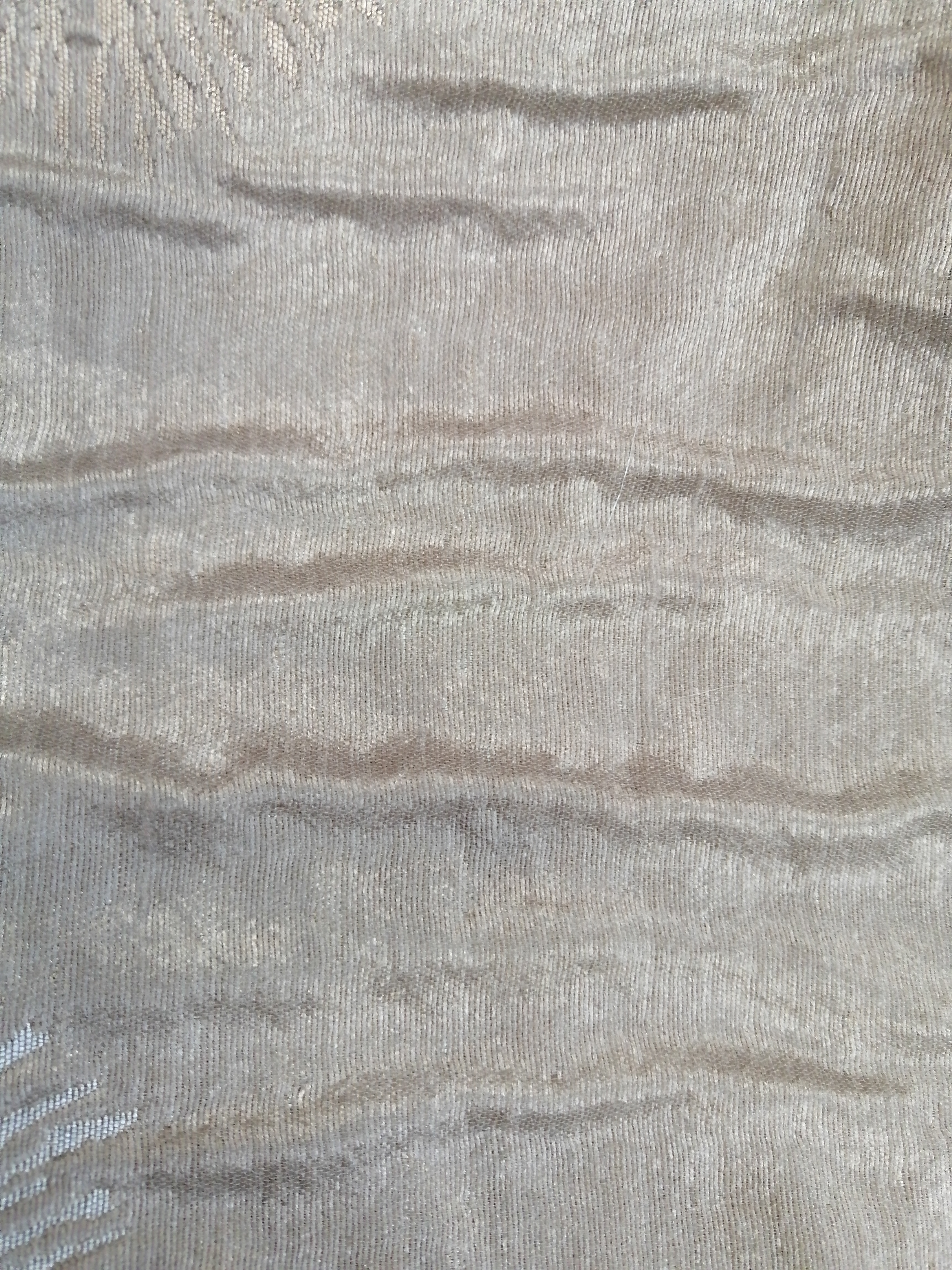

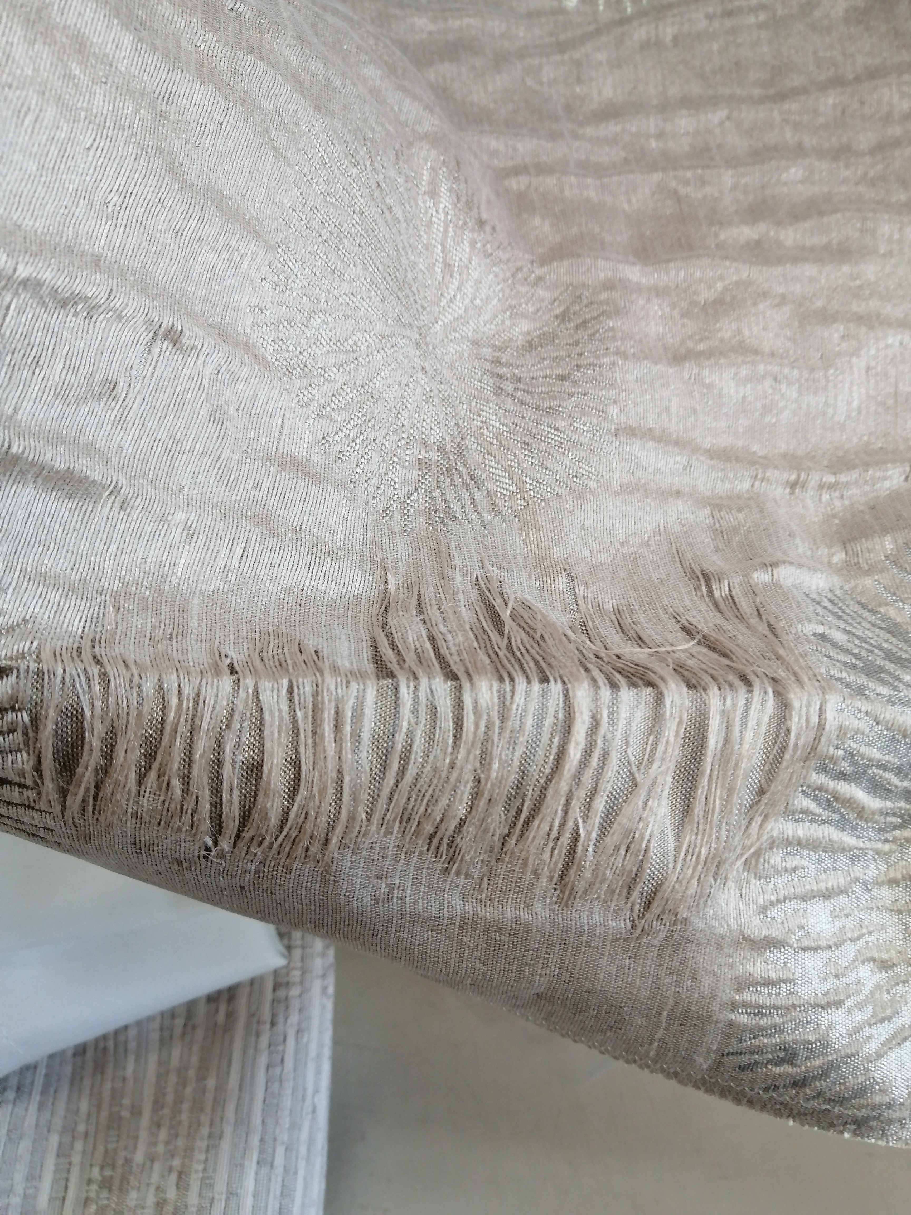

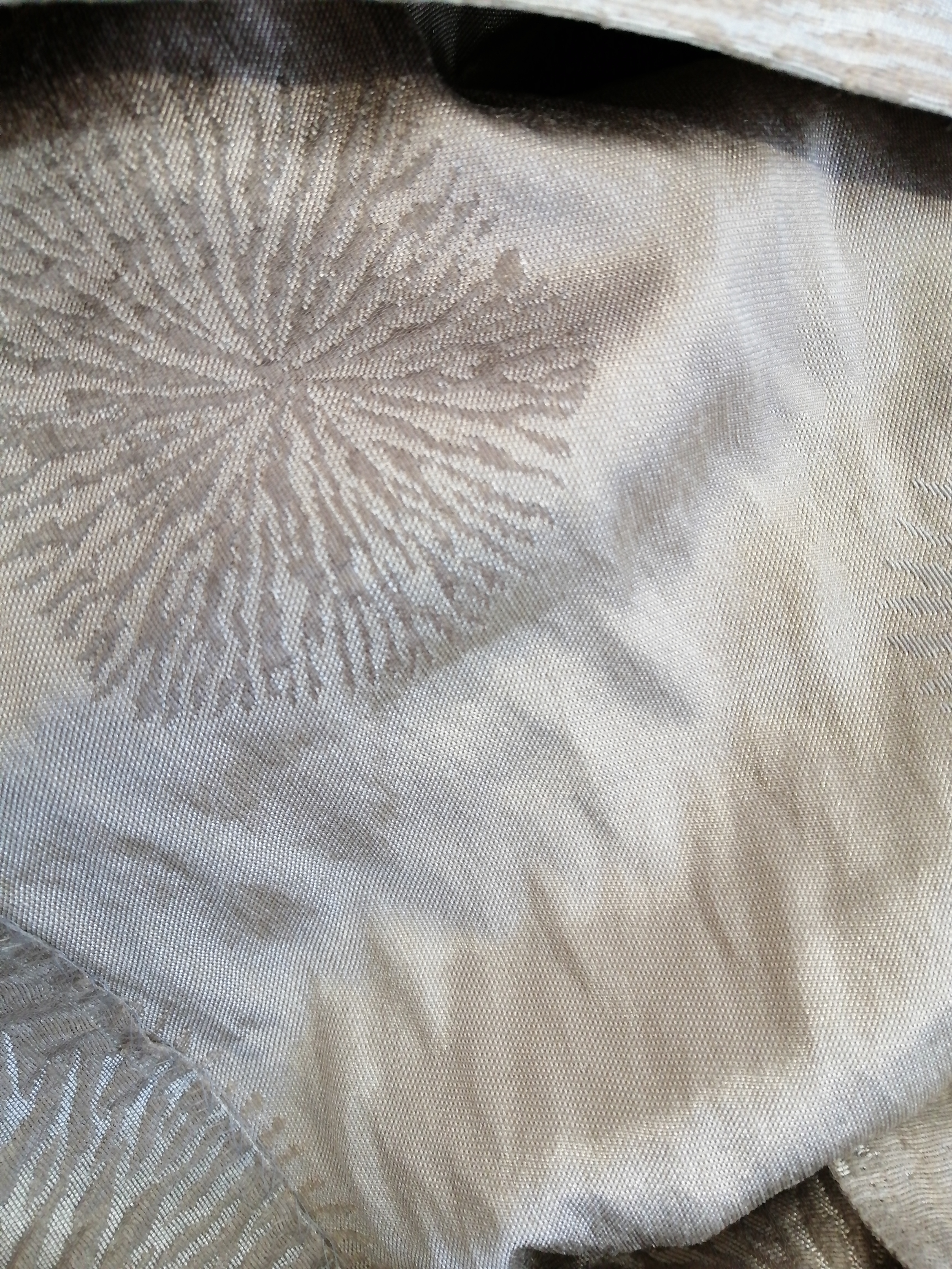

See photos - What fibre is it in this curtain, and what do you think is the probable cause of the loose fibres
The fibre does not dissolve in sulphuric acid, formic acid or sodium hypochlorite. It shrinks quickly from flame but eventually will catch fire and burns quickly When extinguished there is a fairly hard, black bead.
Back of fabric
Front of Fabric
Problem
9,609
Hawaii
The hardness of the black bead sounds like synthetic fiber to me.. As for being drapery, I'd lean towards sun degradation.. While I'm of no use as I've never had first hand dealings with drapery other than smelling OMS when I was 5years old watching my parents clean it..

Agreed.
Acetate is the only regenerated cellulose fiber that melts to a hard bead.
If you want to do a chemical test, it breaks down in acetone.
Sun damage is my guess.
