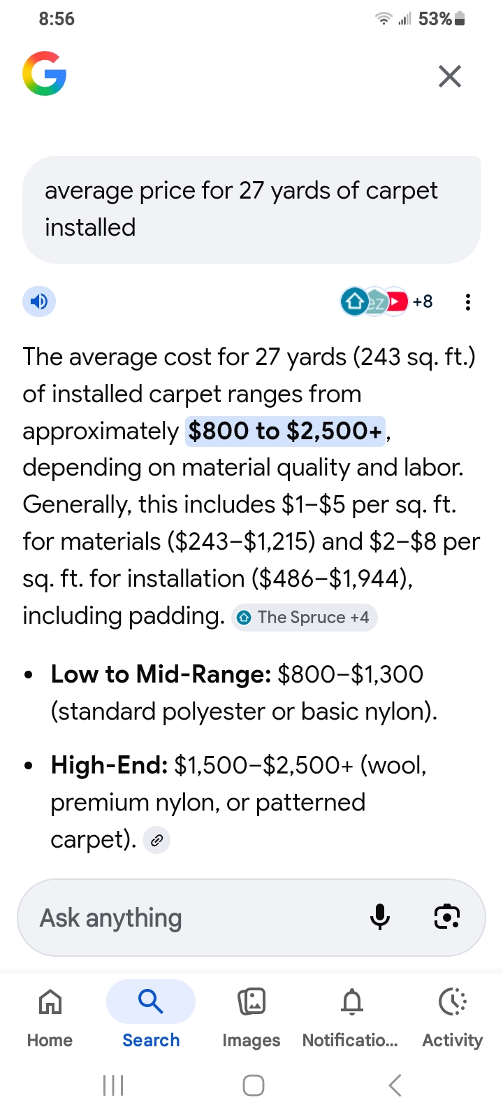

Dwain Ray
Jul 22, 2020
1,175
I cleaned a trashed apartment carpet several months ago and told them it really should be replaced instead of cleaned.
It was 2 small bedrooms. She said she was quoted $1600 from one company, and then $1800 from a different company, to replace the carpet in the 2 bedrooms. That was why she wanted me to clean it. The rooms were about 11x12, and 9x12. I was shocked at how much she was quoted for the replacement.
I would say thats alot!! 55-66.00 per yard, but googling it that's mid range for high end carpet
they live
Apr 22, 2024
1,752
Steve
