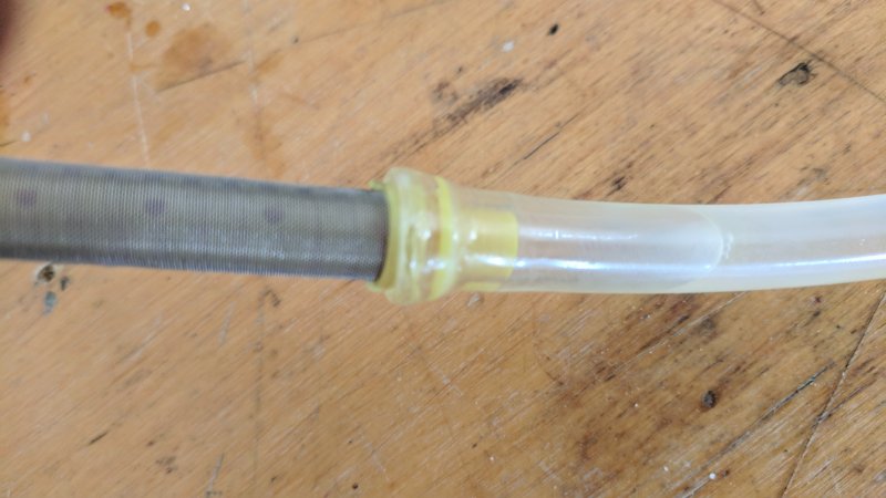

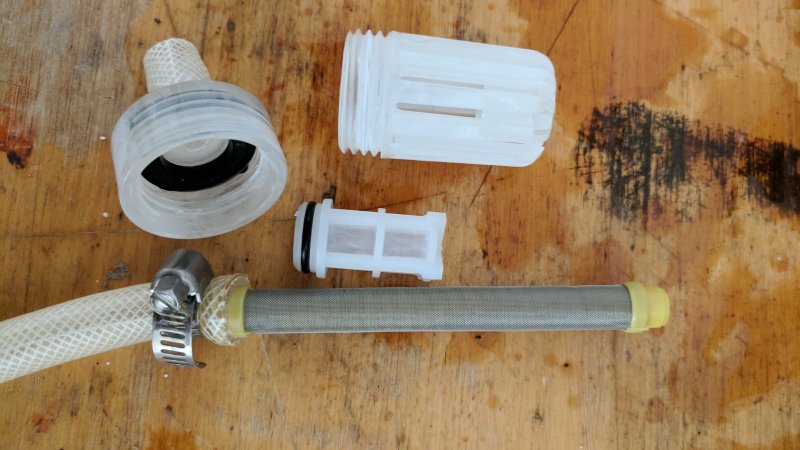

The ultimate fiIter for your HydroForce, Worx or IPS..
Fare more surface area. Use a heat gun to soften the hose and insert. Use a clamp on the Works hose.
Thanks to Thomas L Conway for the tip..
