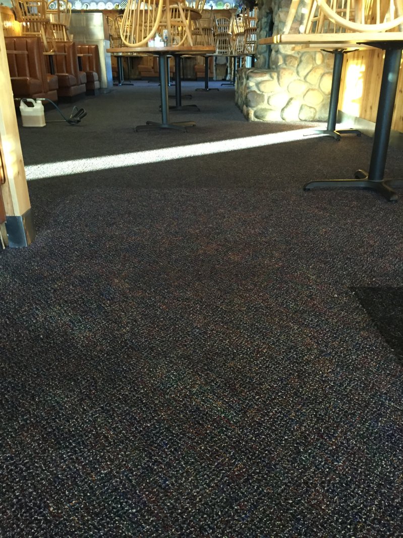

Same restaurant.....last few cleanings and it was blotchy like this all over....
Not this time. Carpet looked spotless.

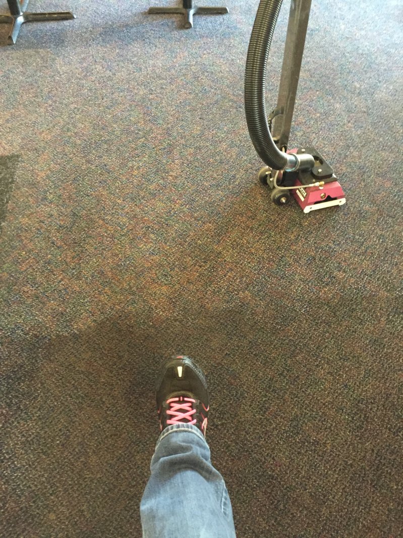

I love the Pink zipper, How much did you pay for it?
It's a 13 inch which costs $2200. And if you order the mounting plate I believe that was $99....can't remember for sure but it is well worth it. Extremely well built! And cleans like you wouldn't believe!
This restaurant was flushed at 600 PSI and the first half was almost completely dry by the time we left.
