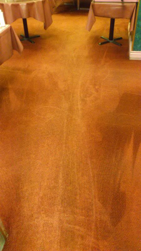

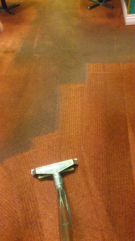

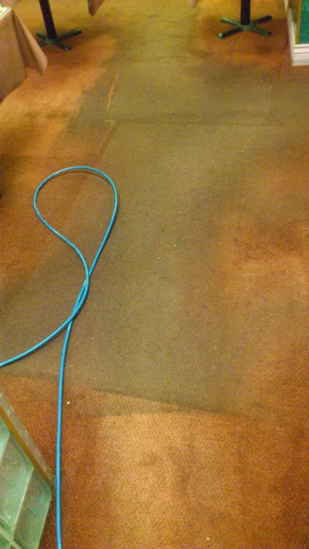

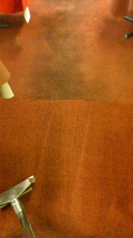

We were given a jug of Flex Powder with Citrus Solv at MF in Vegas. Thought I'd try it on a restaurant I regularly clean, been 5 mths since the last cleaning. I mixed 10oz in the bigger Spraymaster jug, running no tip, 4:1.
I could see it cutting the grease right away just from the spray. Gives Attack a run for its money.
WHat I thought looked really cool was how the steam was getting sucked back in towards the glide. With the old wands would blast back and soak my shoes. I just reshaped my hybrid glide, it had been getting flat. Looks like I got the right shape. Made a couple vids to see the action.

Looks great Ron. Flex w/citrus is the one thing I did 't wait around for years to try. It has given us consistent results for over 6 months now! I would call Flex with a Grand SLAM

That looks really good Ron. I could never understand why restaurants let their carpets get that bad. I don't eat in places like that.

Great job Ron, that carpet looks like brand new! :icon_cool:
Brand new orange....but brand new! :rockon:

They do get it cleaned quite regularly, they missed a couple months this time. Should be done once a month but they go about every 3. Quite good food too.
As I'm cleaning jobs like this I find myself thinking of various posts, ie how well do glides work, or Vortex VS Trinity, how would a pad work on this, would a pad be pulling more out of this carpet than my wand, etc That's why I posted the vids, the angled jets and glide improve the performance tremendously over the old wands. Maybe John was comparing OP to the old wands.

Didn't use an acid rinse, just a alkaline emulsifier metered on the low side, gave it a really good flush as you can see in the videos. SO it was left on the alkaline side but the remaining pH would be lower than what I applied in prespray.
