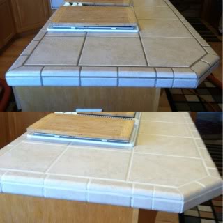

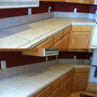

It took me forever and I didn't charge enough. But I got to learn on someone else's dime.
Once I got the hang of wiping it down, it went faster. I kept wiping it off the grout. There was a few areas that someone had repaired the grout with some crap that looked like stucco patch. It didn't want to stick to that very well.
The customer was thrilled and she has some bathroom floors that need to be done.
