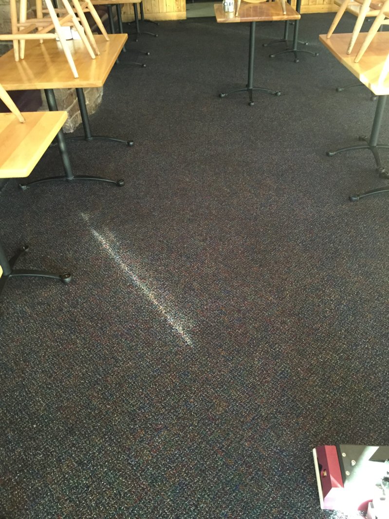

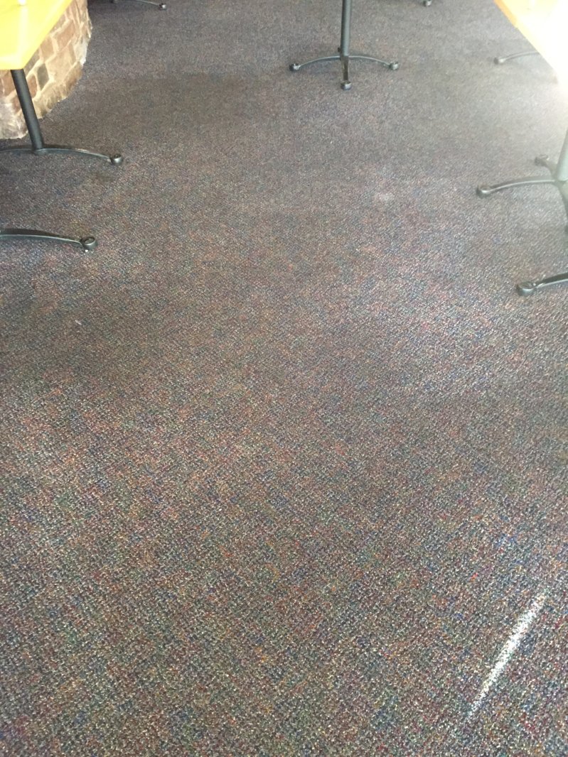

So....we have an account, its two really nice breakfast restaurants. We have been cleaning their carpet every month for years, and they just recently did remodels and for some godforsaken reason replaced the carpet ( we recommended not to as it was not only in great shape, no wear and very clean, even passing the white towel test).
The new carpet is awful. It is extremely low pile whereas the previous had a good loop pile that cleaned up perfectly every time. This new carpet is ugly and is already wearing badly in the traffic areas. Even worse, it is a bitch to clean. It needs intense agitation. The install is awful too....rocks and lumps under the carpet all over the place, The edges are unevenly cut and barely glued down, seams already shredding. We have let them know what to expect and the managers just shrug, the owner is a woman who isn't really living in reality.
I was hoping to try the RV on it but get the feeling it
won't be feasible without the brush head? Or would it work if I slowed the RPMs down? I clean it next Monday so I am hoping I get the brush head before then...Or I can pre-scrub it with a red pad.
Ive honestly never seen such awful carpet! This the before pic.....
And this is after....

Thank you! Between the Zipper and Flex with citrus it does come out great, but I just don't see this carpet lasting long due to wear, especially right where they come out of the kitchen. And they keep the kitchen floors very clean, in fact this place is really spotless all the time. Its an award winning restaurant...best breakfast ever!!!
View attachment 9609View attachment 9610And this is after....
whats the soil type, what rinse?
