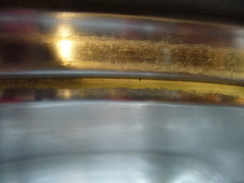

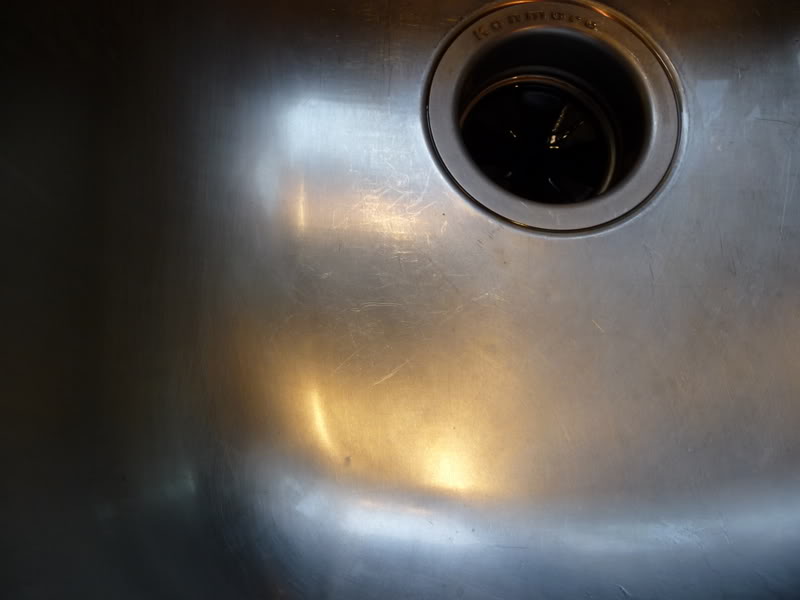

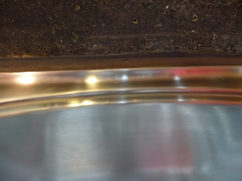

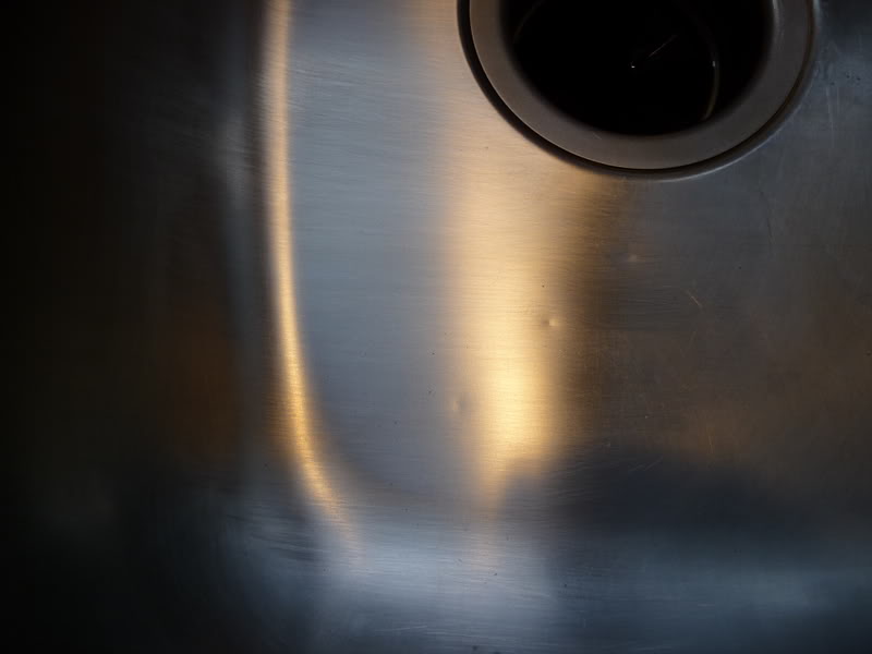

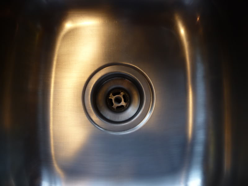

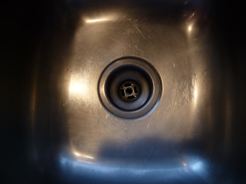

Our SS sink has gotten pretty caked/scratched/oxidized so I whipped out the 3 included abrasive pads, oxidizing/cutting fluid and pad holder and went to town.
Right side sink before
After
Left side b4
After
Edge b4
After
I'd like to learn some tricks for dealing with all the curves and change in direction of the grain on a sink.
Hopefully they cover it at MF.

As a rookie to this process I can already see that pre qualifying the results will be mandatory.
While huge improvements can be made I'm not sure an exact match to a factory grain will ever be possible when doing a spot on a large surface
I would guess whole panels would have to be done for consistency and by using hand tools the grain will not be as perfectly straight as what can be done by a machine, obviously.
Truly anal customers will be a bitch to deal with.
My wife was pleased with what I accomplished though

I think it looks good. I know a lot of customers that would be really happy with those results. I just would get the customers to not expect it to be perfect and think many of them would be happy with that.

The sinks started out brushed and they look way better then "maybe a little" now..

Your right,the scratches are now more uniform :lol:

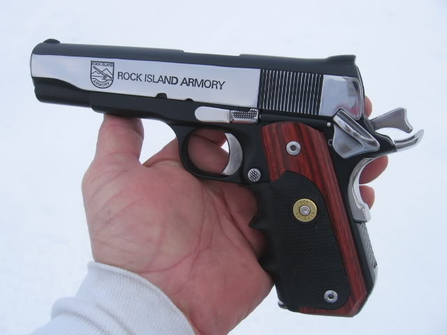

Yo vEEgs, you know i could make that sink BLING like one of my finely polished 1911s, right?
This one is so bright, you can not only shoot game on a deserted island , but signal boats and planes too!
want to make your sink that way?
That sumbee will look like a mirror when I'm done.
You'll be able pluck your eye brows, tweeze your lashes, and put on your mascara in it :mrgreen:
