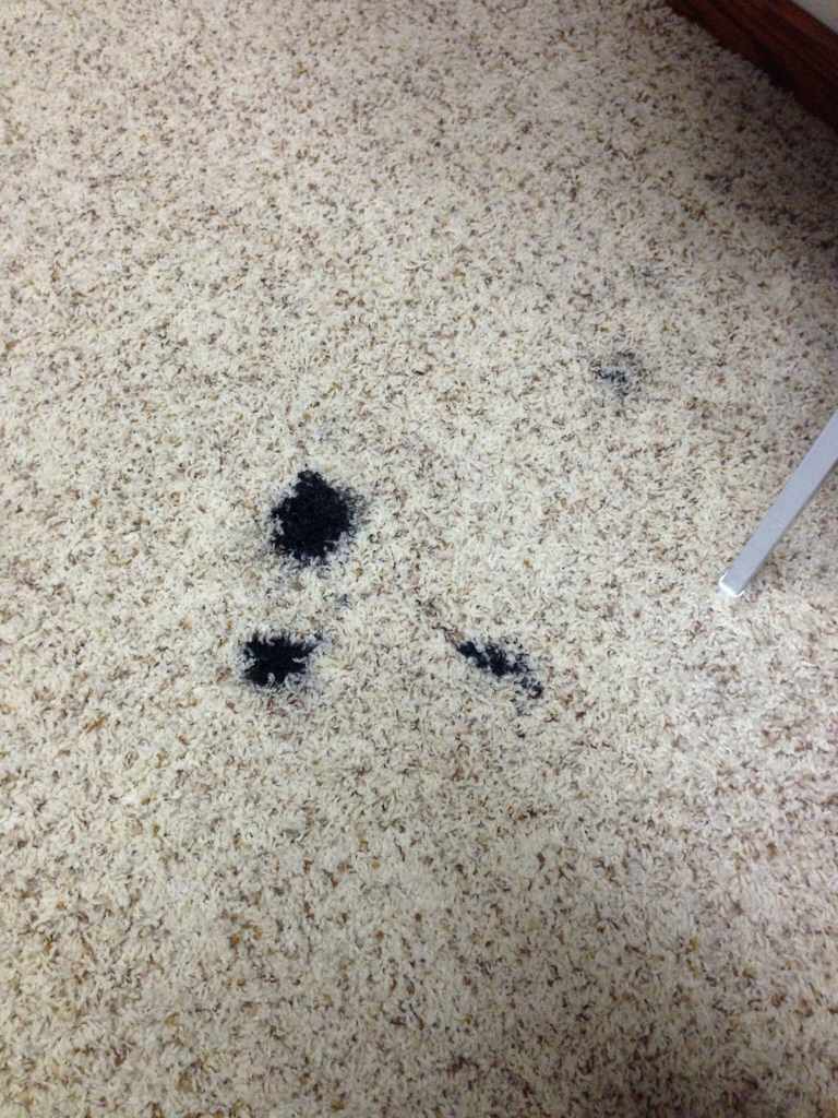

Customer spilled entire bottle of black nail polish just before I got here this morning. I have mostly Bridgepoint products and have a couple ideas of my own BUT.....what do you say? Thanks!

We use Proschoice products for that kind of spot and have had pretty good success. Pro solve gel works pretty good.
PROCEDURE:
Step 1. Apply Pro Solve Gel to deposit.
Step 2. Agitate gently to work gel into deposit.
Step 3. Apply more Pro Solve Gel to cover deposit.
Step 4. Allow 5-minute dwell time.
Step 5. Agitate gently to fully dissolve and suspend deposit.
Step 6. Hot water extraction rinse.
Step 7. Thoroughly blot dry.
Step 8. If a visible stain still exists apply a solution of Stain Magic to stained fibers only.
Step 9. Cover with lightweight terry cloth towel.
Step 10. Apply steam heat from steam iron set at low steam setting (approximately mid range) in 15-second intervals.
Step 11. Check progress periodically by peeking under towel.
Step 12. Remove heat when stain is gone or if carpet color loss is observed.
BUT as Ofer mentioned you might consider sectioning out the stain and replacing with carpet from the closet. It should be an easy fix with that type of construction. The black polish on white may not come out completely.

Since you said Bridgepoint,
I would use All-Solv aerosol to remove the bulk of it.
Then for the remaining discoloration,
I would try a reducing "Dye Stain Remover" like our Dynachem brand.
If that is not successful, then I would try a strong oxidizer with a UV light.
Larry

It was still pretty bad when I was done. Luckily it was in the master closet. I cleaned several apartments after her so was able to leave some fans behind to promote drying. She dropped them off with a check @ an hour ago and said she was very happy despite the limited success with the nail polish. It's all about managing those expectations. Thanks for the help guys.

You might do well to go by a chemical or laboratory supplier and buy some amyl acetate. It is sometimes called "banana oil" but it is not sourced from bananas.
It works well for neon nail lacquers.
Grant
San Francisco, CA
I very much doubt that this level of spill would come out regardless of patience.
It is in the glue layer and backing of carpet. It penetrated fiber deep inside and possible hardened.
Using those solvents will dissolve it (you'd be able to remove some) and further send pigments throughout fiber, backing and enable it to further penetrate into dye sites.
The abundance of solvent needed for that quantity of spill will eventually delaminate the glue layer, fray the fabric, lighten it and still at best leave a black shade.
Which in turn will still require heat transfer to an already damaged fabric that will create its own issues.
Invest your time where you clients money will be best served.

I guess I'm too persistant. Truely believe I'd have got it all out without delaminating anything.
I'd have killed a couple of white towels and a qt of acetone.

My wife dumped a bottle of black nail polish on our carpet, granted it is nylon, off white color, but it came out pretty well with Dynachem's POG. Can't tell it was ever there really.
